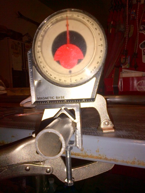

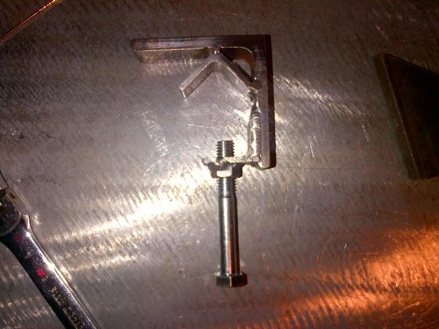

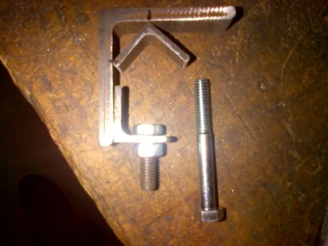

I am going to get bending the bottom tubes here soon. I need to make a plane of bend clamp for the angle gauge. I'm not paying 50 bucks for one. I think mechwerks has them for 30, but I can cut one out of some 1/2" material down at my brothers shop if I can just get over there and use his plasma cutter.

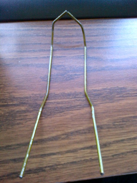

I found this idea on the web. It should work fine for the angle finder mount. I am going to but a new angle finder also as this one is crap.

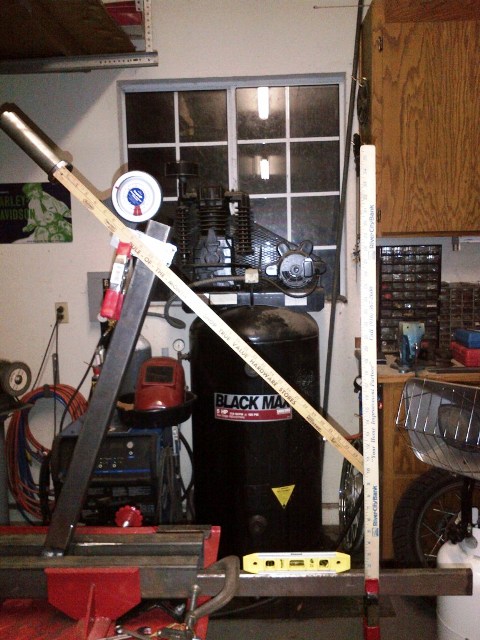

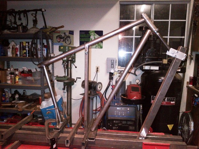

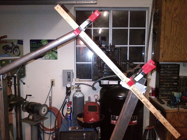

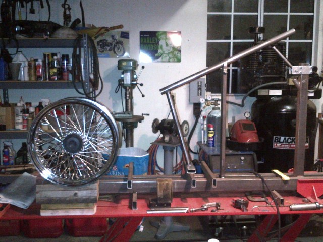

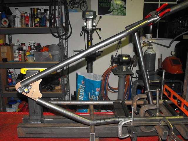

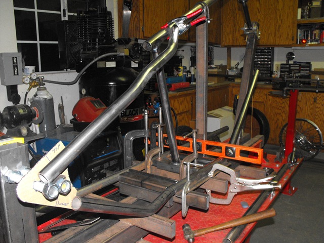

OK a little update. Unfortunately at this stage it doesn't look like much...I angled the neck fixture of the jig forward 20* and then adjusted the steering tube to 45* rake for this 43.5" long springer fork I want to use. I mocked it up with some yardsticks to check the height. I have the top frame tube stretched out another 3" from the plans that I am using, which are already 4" out from a '48 rigid pan frame. Looks like it should fit and look good at this angle...comments?
Looking at the third picture down, you can see that the wheel center is only 9.5 inches off the ground, the small silver sharpie line represents the ground, so that effectively raises my lower frame tubes up.
I know this means my lower rails will be about 4" higher than at the planned height of 5", but when all of the weight is put in, it should come down to it's planned ride height of around 4.5 - 5 inches. Maybe..I hope...
Also mocked up the handlebar riser height and looks like I will need a 12 - 14 inch tall bars to be able to reach them...The springer risers are 6" up from the top of the neck... I know this means my lower rails will be about 4" higher, but with all of the weight put in it should come down to it's planned ride height of around 4.5 - 5 inches. Also mocked up the handlebar riser height and looks like I will need a 12 - 14 inch tall bars to be able to reach them...

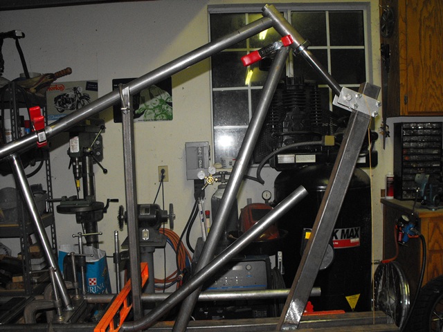

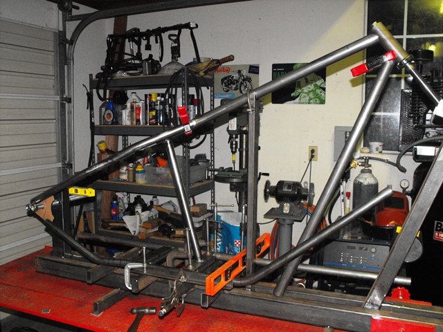

I printed a miter template for the top tube, cut it and set it back in the jig. The angle was supposed to be 45, but it turned out closer to 40 which is OK I think.

Thanks Bob! Yeah that springer is crazy long...I scored a 21" narrow hub front wheel, but the hub is still too wide for the brake rotor to fit.
I'm trying to get my head around how to bend the lower rails and it's giving me headaches! I'm using a single 1.5" down tube and I want it intersect the head tube near the bottom of the head tube. I'm attempting to use parts of two different plans from the CBH; the 200 and front down tube part from the 250-4, but without the radiused down tube. Complicated....I bent up some pieces of wire to try to visualize it. There are 5 bends and 3 rotations in each tube...I think.

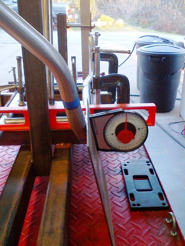

Curt, I think I got it. I bent a 28* angle (opened up from 32 a bit) and I made sure I had exactly 4" between the out bend and the up/in bend. Now my rear tube angle is 25* like it's supposed to be. I know this is why Gary states numerous times that everyone's work will be different and practice is important! I now have a pattern in 1" EMT. Now if i can just copy it to the tubing I'll be good. I still don't know how many degrees to rotate exactly, or from where, but I'm getting there!
I read on chopperweb how JJ does it, bend out then rotate 180 and bend back in and then up to the axle plate, which is what you did Curt. But I want this fucker to match the plans and be symmetrical top to bottom. I also modified the axle plate fixture on the jig to match the dims from the plans exactly.

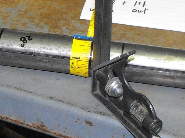

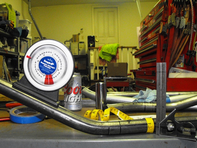

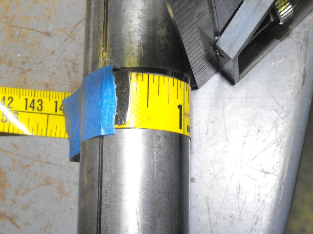

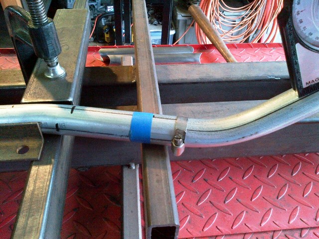

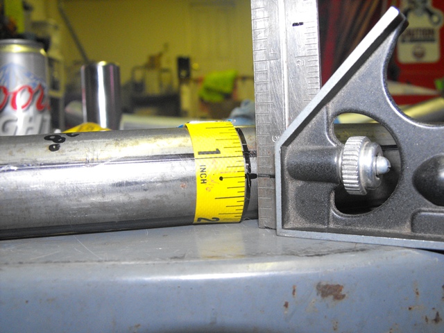

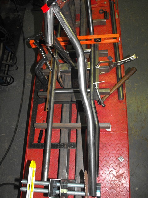

OK, I finally figured out the best way to bend these lower rails on the 200. Here's how: Start at the rear and measure out 15" and mark the tube. I found a piece of material that fits snug over the tube so I can make a line around the tube. Make the first bend, which I figured out on my bender should be 28 degrees (as opposed to the 32 called for in the plans). Lay the tube on a table and set the angle up with a protractor so it's at the desired 25*. Look at the pictures I took that shows the setup. Then mark the tube in the center or 5/8" up from the table. This will be the center line of the out bend.
If you are using 1.25" OD tube as I am, then you can divide the tube circumference into degrees pretty easily. The diameter is very close to 4" so 90* = 1", and 10* = 1/8". even though this is not exact it will work fine for this and it's easier than trying to clamp the protractor to the tube when its in the bender. You can double check it with the protractor also.
So, the distance around the tube from the "up" bend to the "out" bend turns out to be 90* + .25" (1/4"). Using a flexible tape you can measure around the tube and mark it. I am using the center line of the inside radius of the bends to measure from, as that is the easiest for me to visualize. From trial and error using the 1"EMT I figured out I needed a bit more than the 12* as specified in the plans so I went with 13* mark on my bender gauge. I measured 4" from the end of the first bend, this is where the out bend starts. Then make the out bend. You can check that the bends are correct by laying the tube back on the table and clamping a plate to the edge of the table then setting the tube up against the plate and aligning the tube with the edge of the table and measuring from the edge of the table to the tube. The tube should be parallel with the edge of the table.

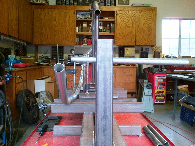

Re: Irish's CBH CR200
Moving on to the front, measure 17" from the end of the "out" bend and mark the tube. This is the first bend of the "ramp" up in front of the motor. The tube is angled in toward the center of the bike 10* also, so you will need to rotate the tube in the proper direction depending on which side you are making. So 10* = 1/8" of rotation.
