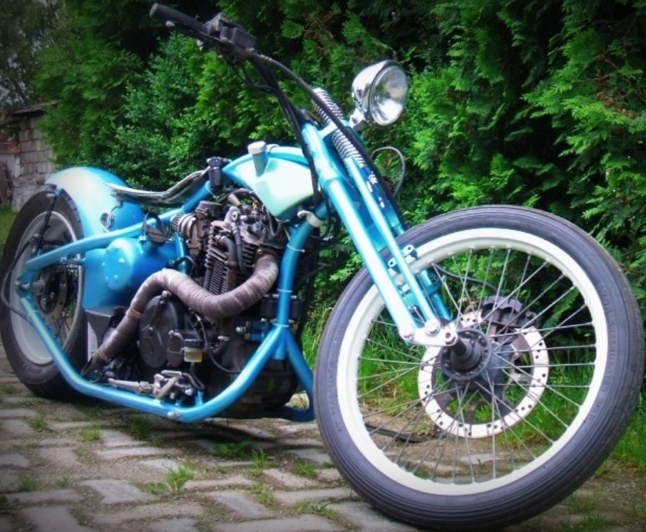

Nice work, it will be a sweet li'l machine when you finish.
I was hunting for an XT500 for my project, but they're regarded as "classic" bikes over here nowadays and the money for basket cases was crazy, so I went with an XT600 instead.

Glad you guys like it, its a good place to share it then, the xt has a cult like following, I got some sweet take off parts with this and doubled what I bought it for, I had a sweet aluminum tank that sold for around $500, that went to the lower states some parts went to europe, it surprised me....so I got a stroked crank for it, got the heads ported by hoose racing, got a 540 piston I am going to try my hand at boreing my jug myself, and do some reinforcing machine work I have read up on on the sr forum, for race engines, heres a shot of getting the wiring worked out and it sitting on its own feet..

I believe bored and stroked I am at 580cc, should be over 45hp, under 300lbs hopefully, theres a suzuki dr 750 chop that was inspiration originally for me
