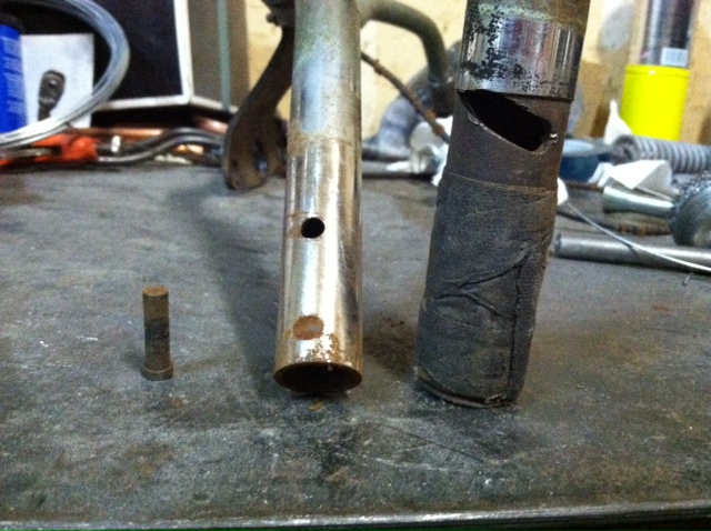

Re: internal throtle cable build
Don't know if this will help,but I started taking the Handle Bars on the Simplex apart Today.This is how the slotted Throttle Grip is held on.What I didn't get was showing the Hole on the other side of the Bars.The Pin sits flush on the other side.
How does that move the cable?
Does the whole grip move outward off pin not rotate in one spot with the cable clamped somehow on the end of the grip/outer tube?
Thanks for sharing!
Thanks for sharing!
- Posts: 696
That's right...the whole Grip moves outward as you twist it.the Cable is held on the End by a little Barrel Clamp.
