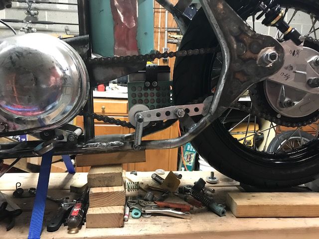

The chain tensioner I made couldnt take up all the slack, so I milled slots in the arms. Made a new tensioner & this time the slack is taken up. Still have to dial in spring tension & once thats done Ill move the spring on the inside of the tensioner.

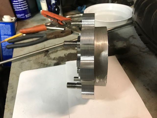

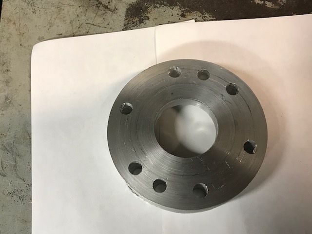

The drive side is pretty much done.1st I Made a spacer & then made the sprocket mount. This part was actually much more complicated for me than it looks. Made up some stainless studs to hold the sprocket. Also got the axle adjusters made. Started on the brake side tonight.
There will be 6 stainless studs running from the brake through the hub & into the sprocket mount, but I thought Id put a couple roll pins in just for a little extra.
be careful with stainless hardware on brake and drive components they usually are brittle and tend to shear under high torque . id hate for you to get hurt or wreck your hard work
My thinking is the bike doesn’t have the weight like a Harley or the balls of a hyabusa. There will be 6 5/16 & 5 3/8 studs sharing the load on each side.

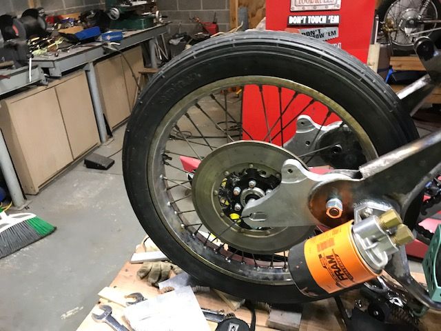

Brake side with the exception of making a few studs (decided to go with Curts advise & not make them from stainless) is basically done. Had a couple of set backs, the original rotor I planned to run didnt work out. Then I tried to mill round holes in the stock rotor....that wasnt happening either. Searched around & found the rotor the way I wanted it. I plan on drilling holes in the braking surface, & still have to mount the caliper.
