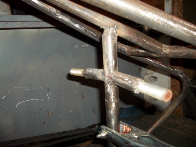

Finally more progress on my build, got hardtail almost all done. Axle plates all welded in place, working on the seatpost and lower frame rail spacer tube coping. Then get it all tack welded in place. :D :obscene-drinkingcheers:

Got seatpost and lower spacer tube tack welded in place, So going to check engine fitment again then fully welded it all in place. :D :clap:
100_1750_zpsa44e7049 Seatpost tack welded in backbone tube.jpg (191.84 KiB) Viewed 19123 times
100_1748_zps1265b28e seatpost and frame spacer tube tack welded in place.jpg
100_1748_zps1265b28e seatpost and frame spacer tube tack welded in place.jpg (239.52 KiB) Viewed 19123 times

Is there a particular reason you put the Braces back on the Backbone to the Legs?It looked much better without.Have you given any Thought to redesigning the Gusset so you wouldn't need them?But if the Tank will hide them guess it doesn't matter.....You disappeared for awhile Dude.....glad you're back on the Build.

Hey Jeff L, I did the bracing the same as Honda had the frame. I need in between to mount my dual coil system for engine, if I did big gusset in between then no room for coils. Still learning and designing as I go along, not quitting on the build just been busy with life stuff.
