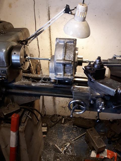

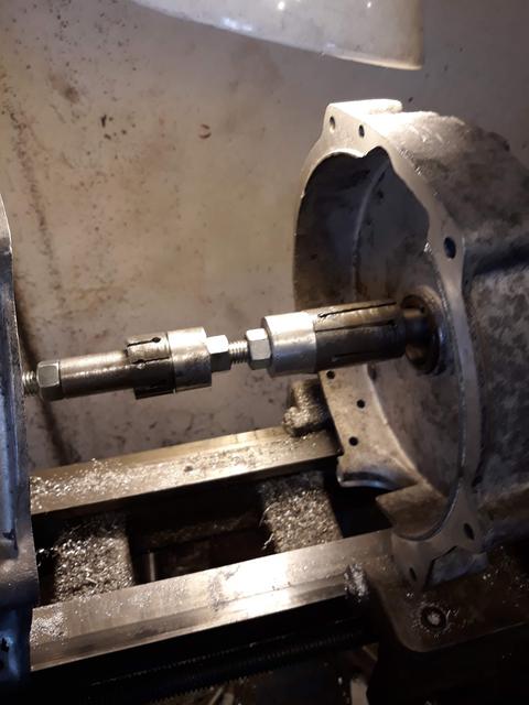

At 12 X 36 it's the absolute minimum you can get by with.

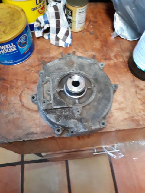

Here's the other side I'm turning the od of the main bearing boss down so I can shrink a steel sleeve on it.

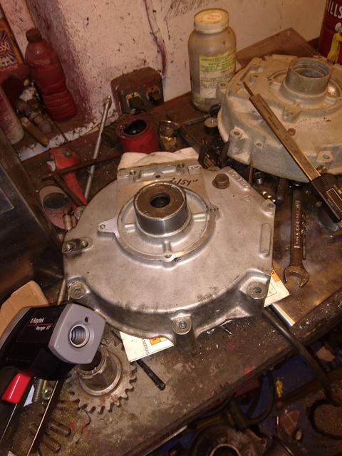

I started a 1935 today the sealing surface cleaned right up at .004" but some idiot broke the threads off the end of the main bearing boss. I welded one of these up once and it took forever to weld and machine. So I turned this one off flush wit where the bottom of the threads should be and am going to make a steel sleeve with the needed threads and shrink it on.

Made the sleeve for the 37
Heated to 953 degrees f and it slid right on, at -.009" I suspect it's there to stay and should strengthen things up a bit.

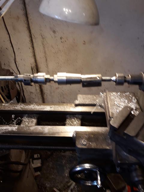

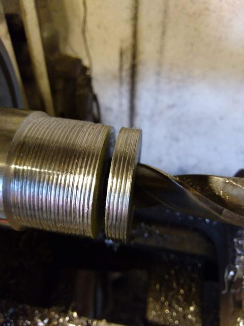

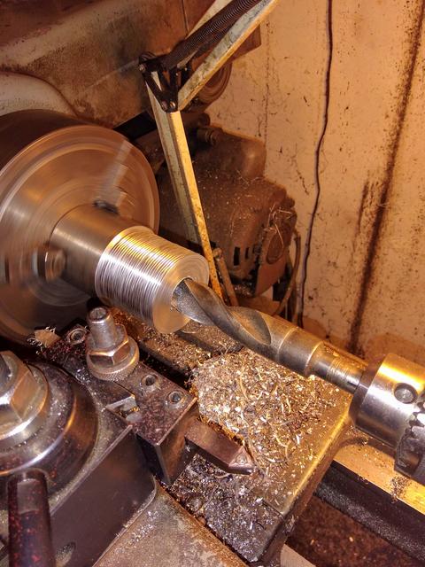

Turned a length of shaft to 2" and threaded it 16 TPI LH squaring the end up in this pic
Drilled a little pilot hole
Big enough to get a boring bar in
Parting off with a hacksaw to save material ( I buy this stuff by the inch)
Parted off
In the fixture for more machining
Boring to size
Cutting the left hand spiral that is as close to an oil seal as a 30s Indian Scout had there.
Sleeve shrunk in place and the nut torqued.

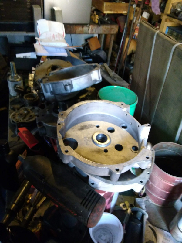

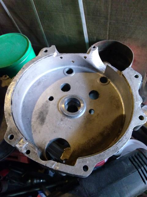

The other case half I'm going to use with the 35 left side is probably 39 or later if the pushrod guides are original to it. It had a tiny crack .
Then I discovered that the pinion race bore is well machined just to an odd size that isn't available now if it ever was. So I started making a pinion race with a .0075 oversize OD.
This drill bit in rockwell 45 shaft is all the little Atlas Craftsman wanted even in back gear.
Re: Dusty's Bonneville Scout Build
Forgot to get a shot of boring to size and parting. Boiled the case for 3 or 4 minutes and the race drove in at a medium hammer fit.

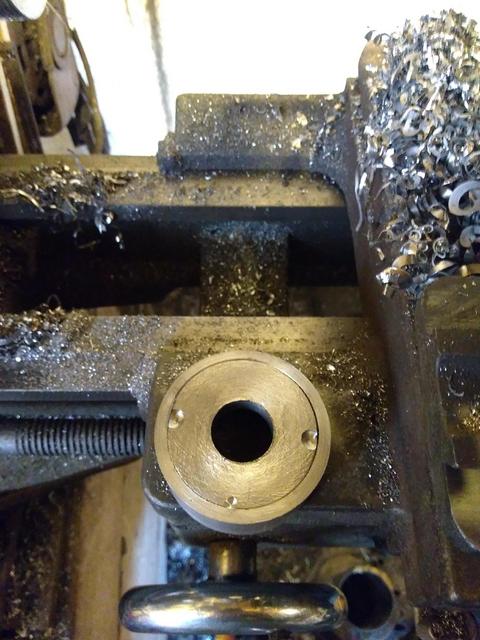

Welp melted the armature in the Dumore so I made a line hone instead
And started honing the main bearings.
Checking progress

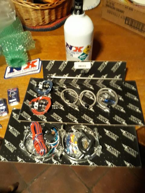

Out of 4 cases I saved all but 2 races. I had one drive shaft race in stock and the other should be here Friday. So Im kinda stalled and decided it is time to order the Nitrous stuff. Does anybody here have any Nitrous experience? I'm prolly gonna go with Nitrous Express unless somebody has a better suggestion.

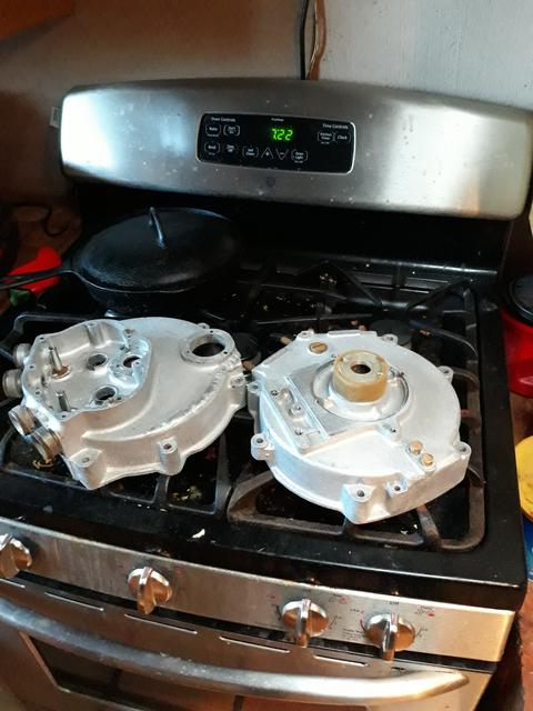

Since I'm a firm believer in not sandblasting cases and these needed cleaning.
I gave em a little soak in warm Pinesol.
then ran em in the dishwasher.
Got a few goodies today.

Just pure Pine Sol The generic knockoffs don't work at all they don't have the right kind of acid. Any kind of pan seems to work, Don't heat it too hot I try to keep it just as hot as I can stand to put my hands in. The occasional wipe with a stainless pot scrubber hurrys things along. When I'm pretty sure it's clean enough I run it through the dishwasher. When the Pine Sol in the pan is cool I dip off the nasty stuff at the top then strain it through a rag back into the bottle for next time. As long as you don't boil it and strain the oil out it works again and again.
OBTW
Don't decide to put pinesol in the dishwasher as a shortcut! It'll fill the kitchen knee deep with suds!
