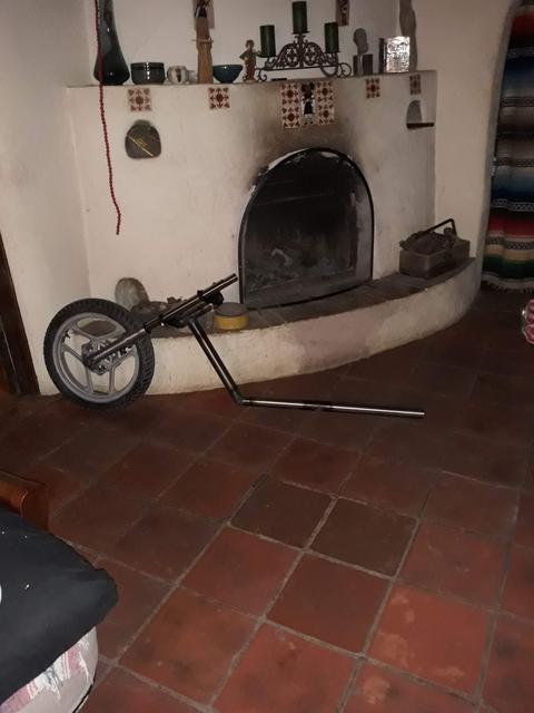

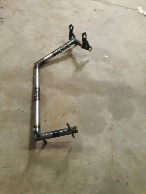

Couldn't find the Aircraft seamless 4130 tube in the wall thickness my engineer said I needed at a price I could afford. So I bought some heavy wall and turned a few pounds off.
Sawsalled and ground the tubes off the Ninja neck as close as I could then spun the rest off.
Looks like it's ready to weld.
The first two pieces of the lower tube welded and the neck mocked up. Can't cut the front lower tube until the bearings and seals get here to put the fork and wheels back together.\

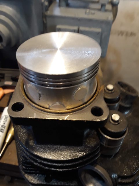

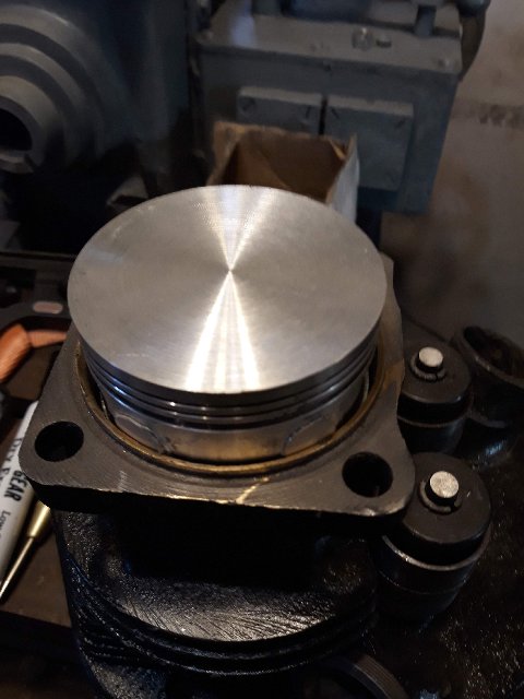

Took awhile to talk myself into drilling holes in brand new pistons.
OBTW all those holes have peek buttons now and are fitted where even after warming on the wood stove they fall to the bottom of the cylinder.

Made a dozen little PEEK buttons to go in the piston skirts.
Parting off the little bowl was an important tool
Lots of fiddly work for something this simple
In place!
In place!

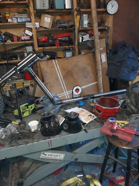

Got the frame standing on its feet. It's adjusted as long and as tall as it gets.
Started fitting the right tank -top frame rail
Proly leave the tanks just tacked up untill I get the engine in it.
