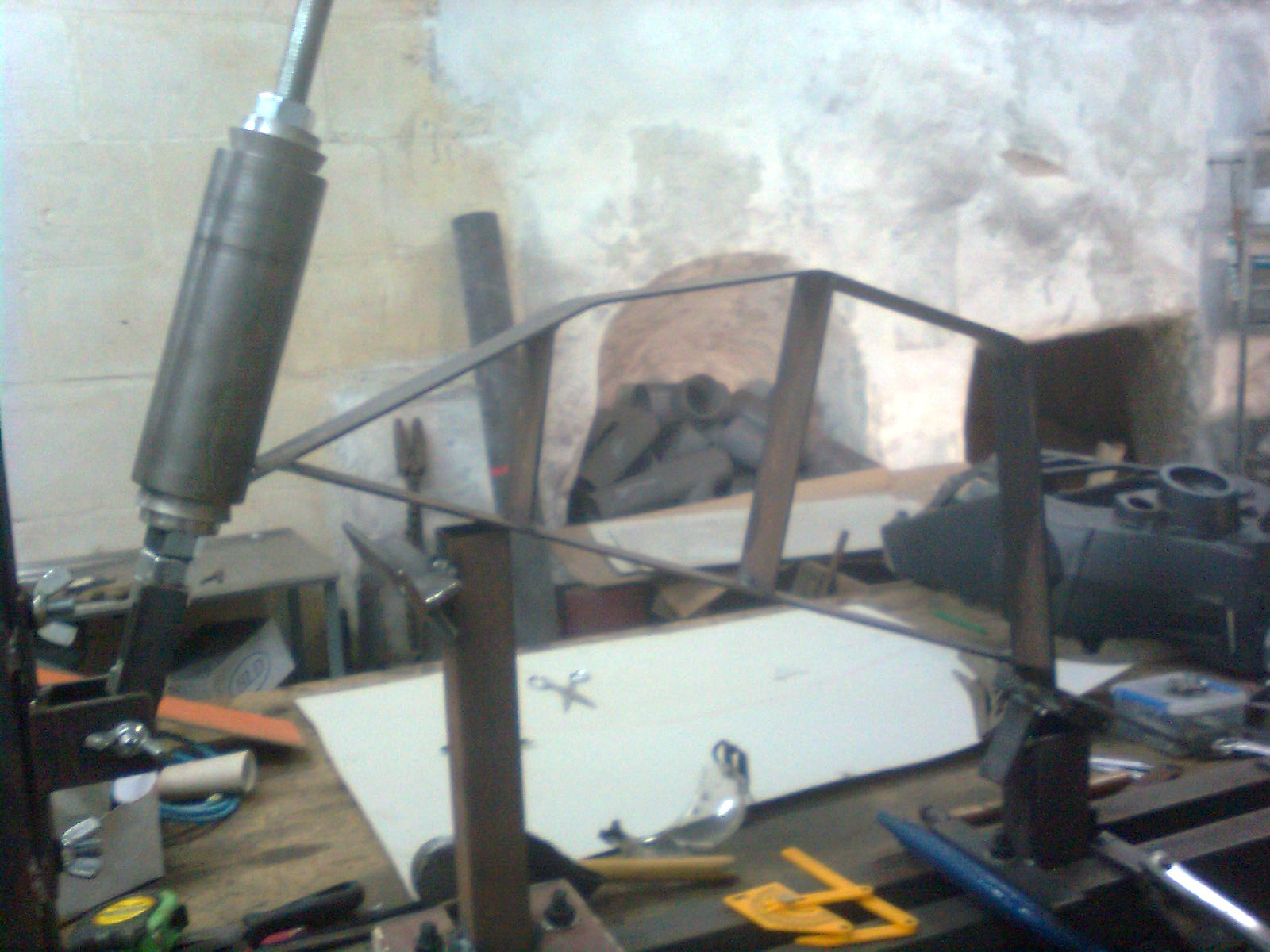

Re: FIRST BUILD BUELL XB9...sort of
Post by ta borom »
constructed a triangular section to form the upper part of the frame...and drilled lightening holes in it...plugging them with stainless tubing
