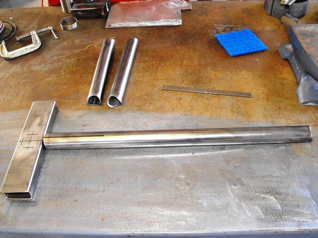

I started (again) on the new chop this past week. I got the seat post x-member and seat post fish-mouthed and cut, and also mitered the rear wishbones. I'm using the blueprint from the CBH for the CR-200 (Custom Rigid) with wide rear wheel. I'm using a 1.5" backbone instead of the 1.25". I also want to use a single down tube instead of the double tubes running up from the front motor mount. I'll bring the lower rails together just above the front mount and run another 1.5" tube up to the head tube.

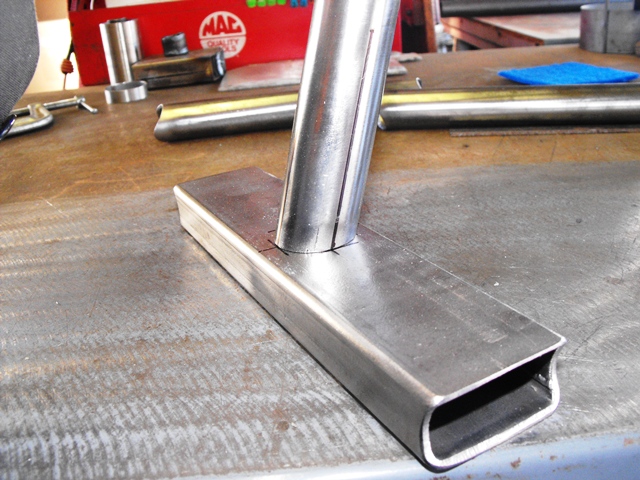

seat post cross member and seat post mitered and cut to length ready to tack

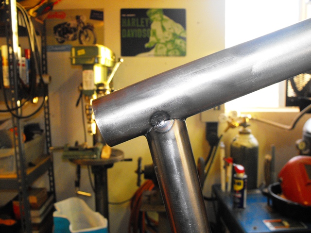

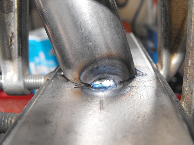

I used the Tube Miter program.

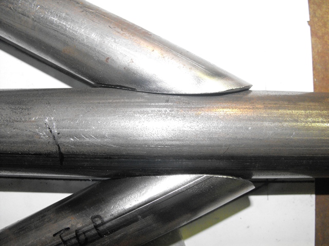

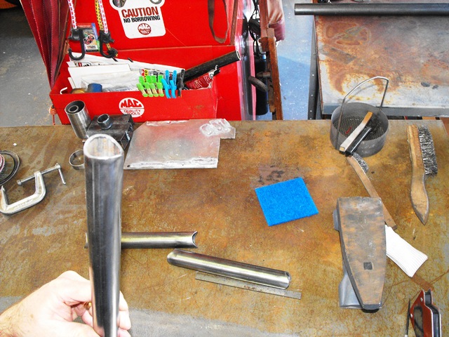

rear wishbones getting fitted to 1 1/2" backbone
final fit up is nice and tight

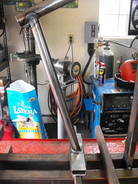

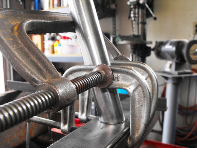

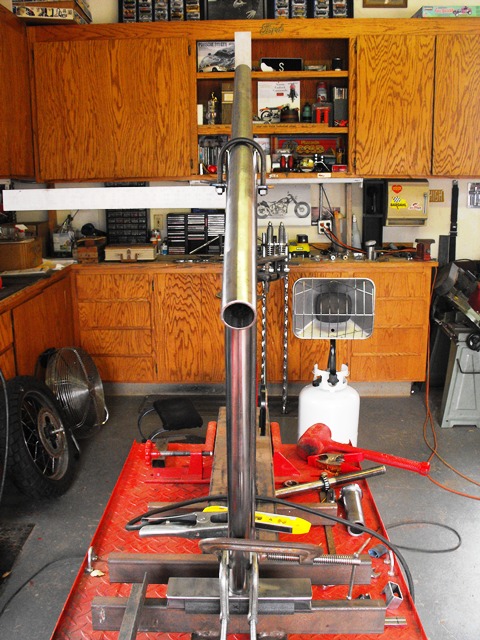

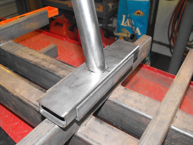

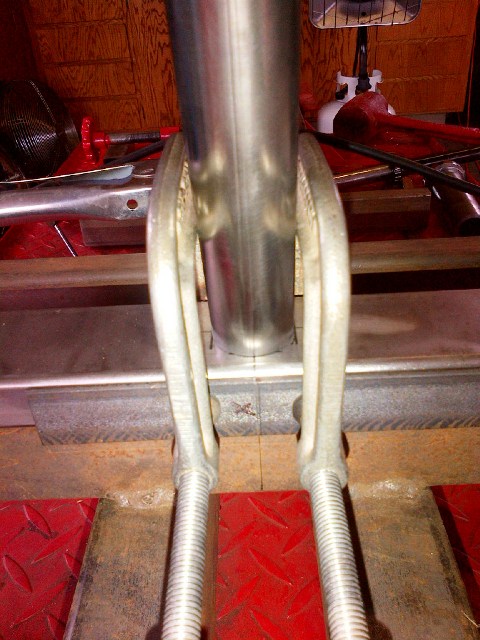

Day 2: I tacked the top tube to the seat post. Then I welded two lengths of 1" angle to the cross bar on the jig to hold the seat post cross member in place. I then wanted a support for the top tube so I set up a length of 1x2 rectangular tube at 25 degrees from horizontal and used a 1.5" hole saw. I then sawed through the center of the hole. I will weld tabs to each side of the pieces and drill and tap them to make a clamp to hold the top tube in place.

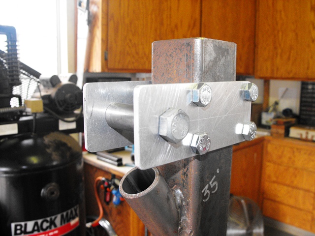

As I mentioned earlier I am build the jig as I build the frame so I can reproduce this frame over and over in the future. I am going to make the head tube fixture adjustable so that the rake and height of the head (steering) tube can be changed for different degrees of rake and position. That's next.

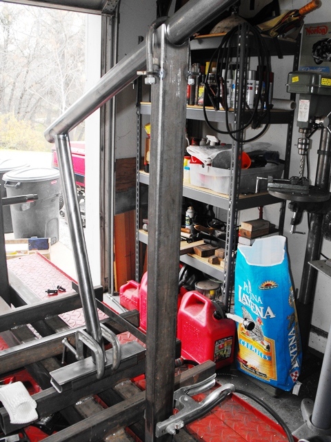

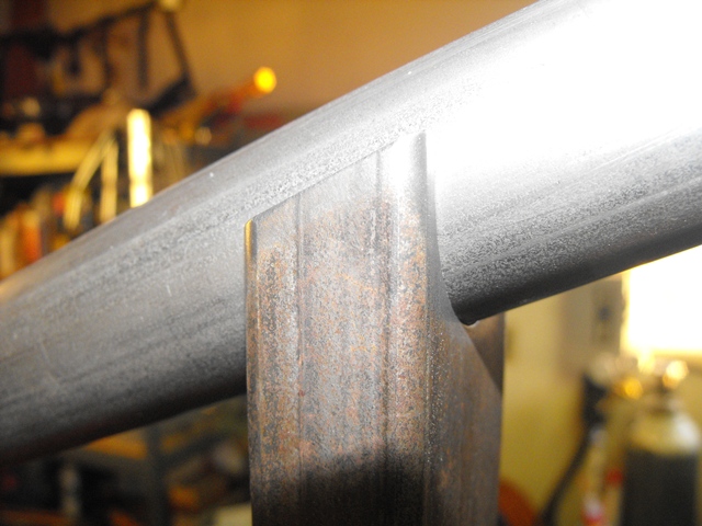

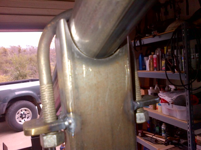

OK another update: Over the past couple of days I got the upright that will hold the back bone (top tube) welded in place between the jig rails and I welded two tabs on either side of the notch at the top of the upright so I could attach a U-bolt (which is actually a 2-1/4" muffler clamp I had laying around) to hold the top tube firmly in place in the notch. I realize that this upright is not adjustable for height at this point, but later on if I want to change it for a different frame I can make it adjustable. I'm trying to do this as simply and inexpensively as possible, so I am trying to use materials from my scrap heap.

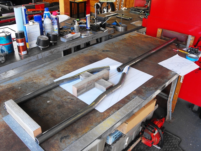

So after I completed that I clamped the tube in and lined everything up. I beveled the bottom of the seat tube and tacked it to the cross member. I then pulled the assembly out and welded it out on the bench. Next I'll attach the rear wishbones to the top tube and then it will be time to bend the lower rails. I may need to get some more tubing as I only have 10 feet left and I'm not sure if I can squeeze both bottom rails out of that or not. I am going to use a single lower down tube from the neck, so maybe...

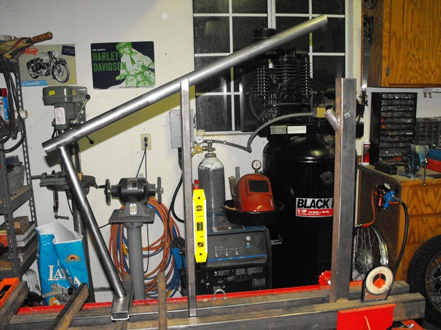

I also cut and drilled some aluminum plates for the adjustable neck holder. I need to decide whether to use 3/4" round bar or threaded rod for the neck holder. I am thinking of maybe using round bar and boring a 1/4" hole in the end to be used as a pilot hole for a hole saw for cutting the top and bottom tube notches for the neck.
