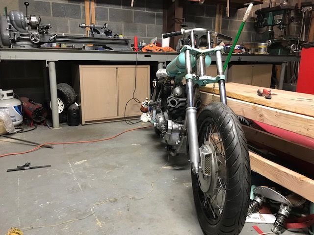

So as I said the triple gave me such a headache I decided to cut my losses & sell the engine (after much thought)...Enter a 62 Norton Atlas 750...

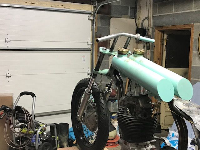

...This engine didnt fit in the frame so I cut the down tubes out...

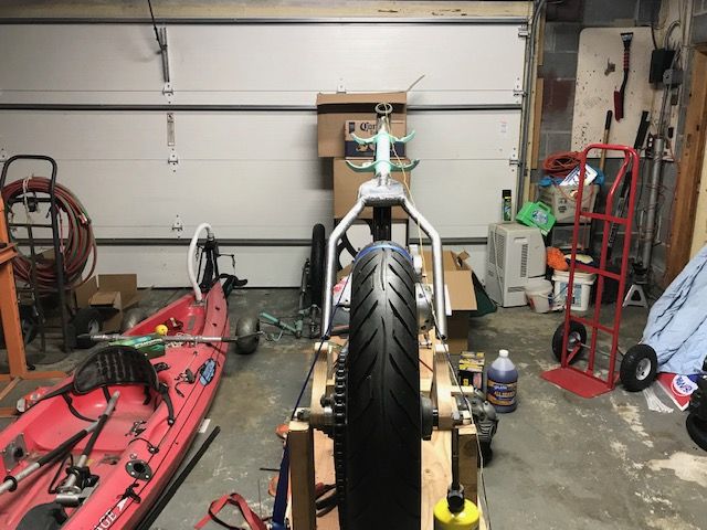

I the bottom rails were also wbay to wide. I could have used spacers,but wanted a cleaner look. I made up new bottom rails that were only as wide as the motor mounts.Bent some new down tubes
Once that was done, I figured I might as well change the seat post & made gussets for the neck
This is where Im at now. I plan to increase ground clearance ,so a redesign of the rear is going on now.

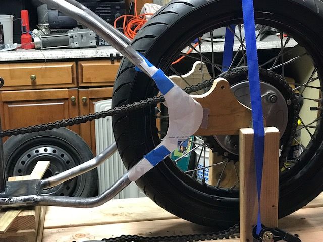

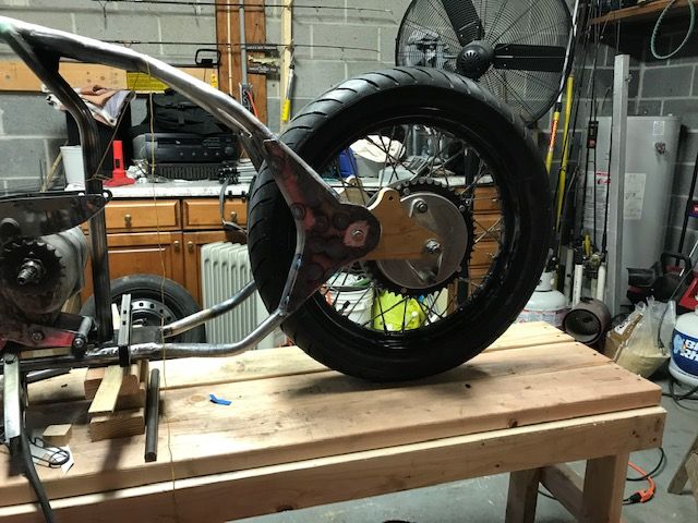

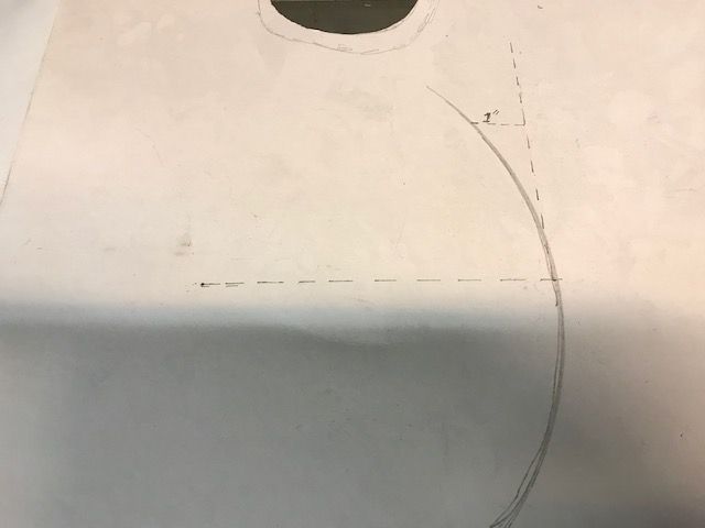

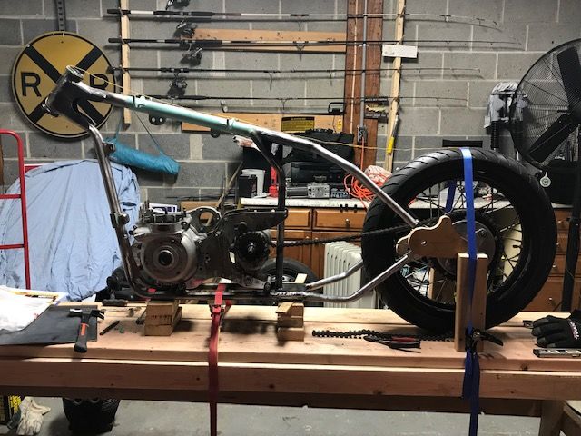

some more work on the frame. Now to make the axle plates. The last pic show the shape of & hopefully how the rear wheel will pivot giving me a little rear suspension. Ill be mounting shocks on the seat rails.
I got the plates made up & tacked on. Mocked up the wheel to see how it looked. Not sure if I will use shocks like this or go with a regular type shock. Last pic shows the deflection from vertical. 1" at 6" of total travel, but really not looking for much. Just enough to soften the ride a little.

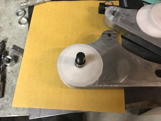

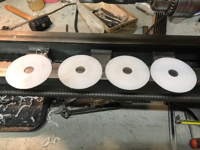

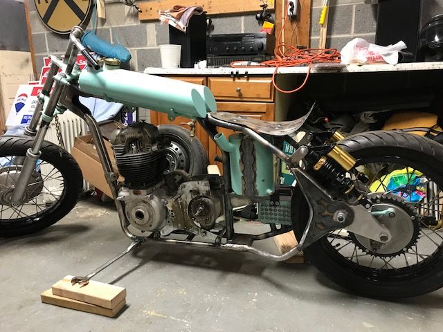

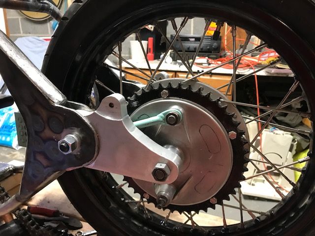

Its been a while since Ive updated this. I made the swing arms from aluminum. Bought a chunk of nylon to make 1/16 thrust washers from. I milled a little under that from the arms. Also installed oil-lite bushings for the axle & shocks.

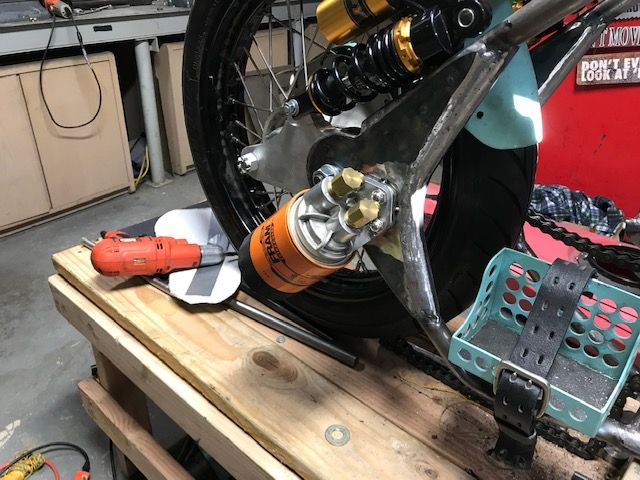

Made up a seat pan, mounted the battery box, & oil filter. The brake stay is on & got rid of the speedometer gear (will be using a speedo app on my phone to keep the bars clean as possible.

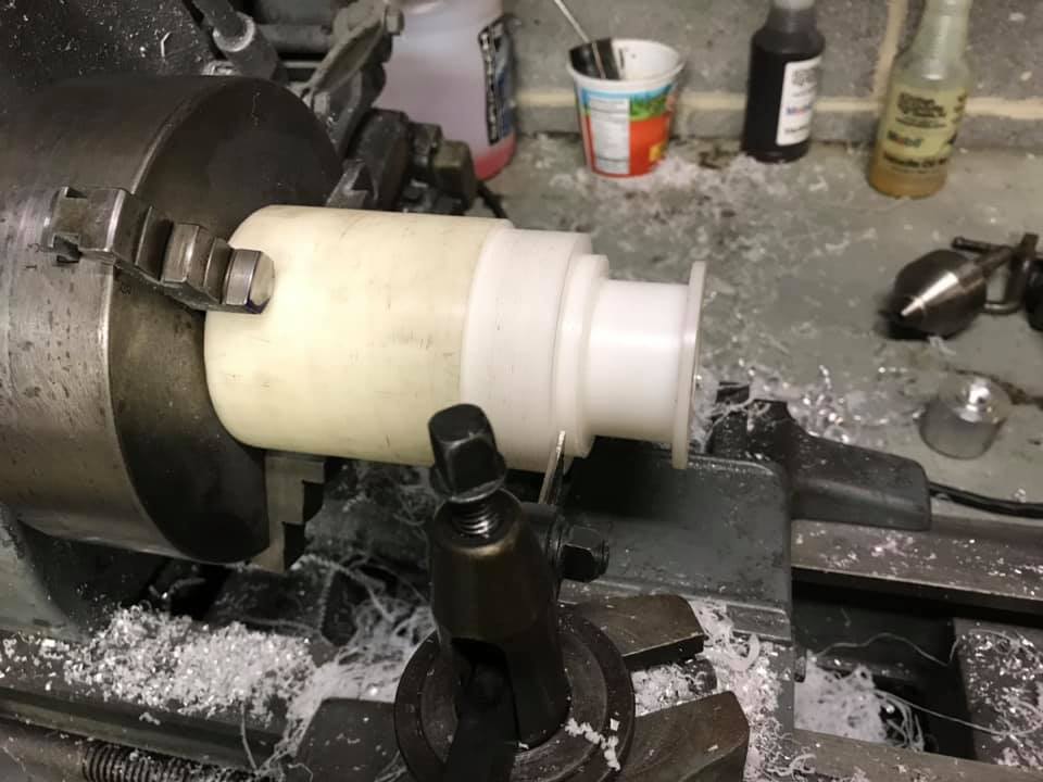

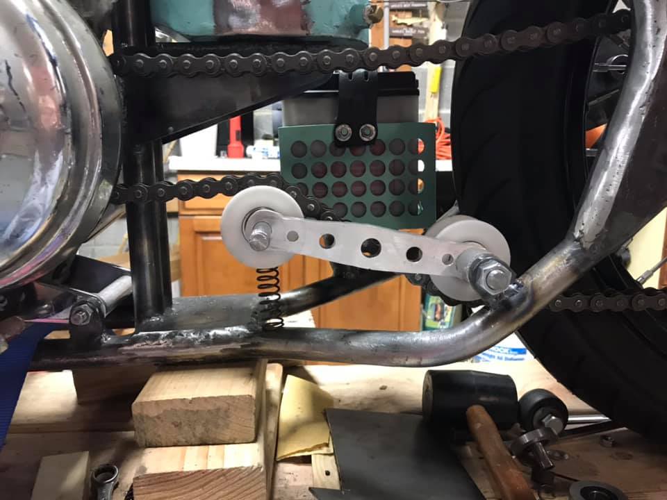

I didnt realize thered be so much slack in the chain. I made this tensioner out of delrin.

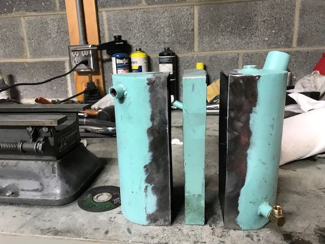

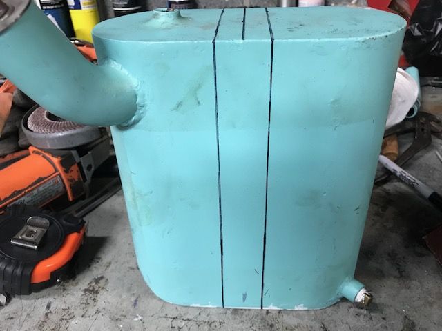

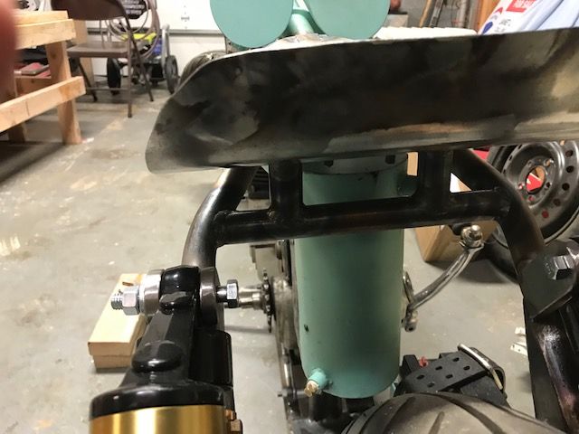

Have you ever made something, stepped back & said...yeaahh...I like that? Well thats exactlly what I did when I finalized on the seat mount. Right after that I went to put the oil tank back in & it didnt fit....WTF...I didnt want to change it cause like I said I really liked it. So I cut a piece out of the middle of the tank & welded it back together.....all good

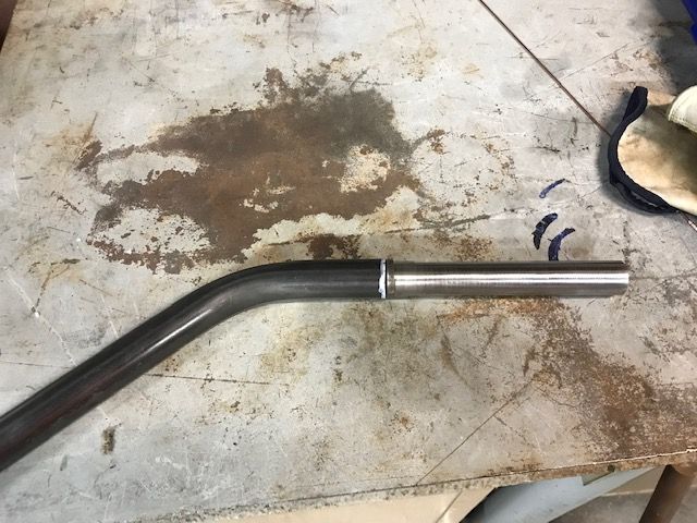

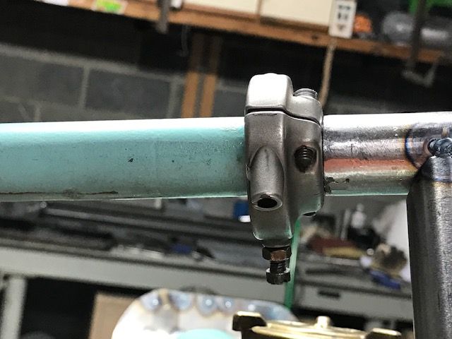

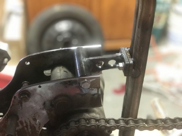

Made up the rear motor mount & made a set of 1" bars running a 7/8 throttle
