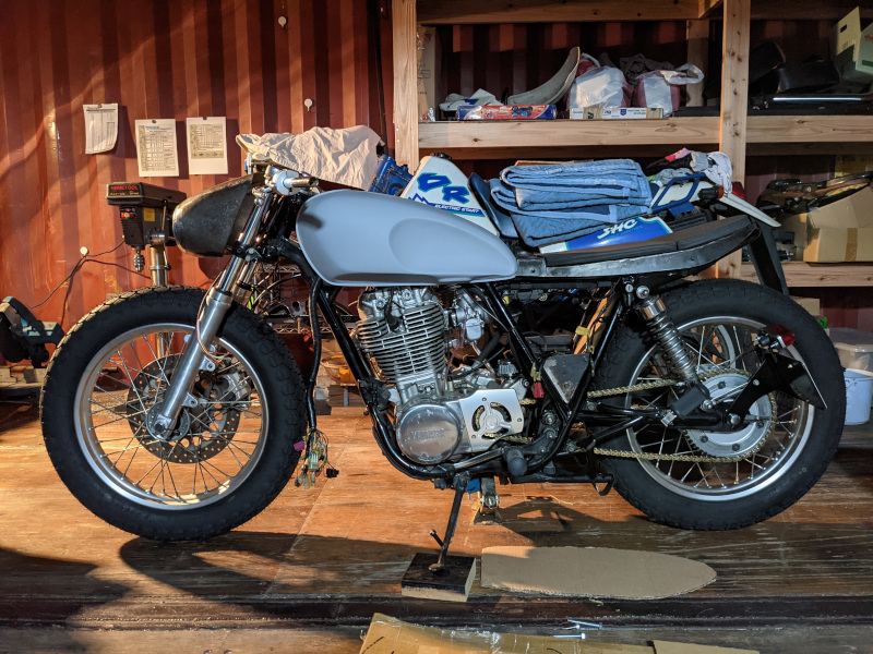

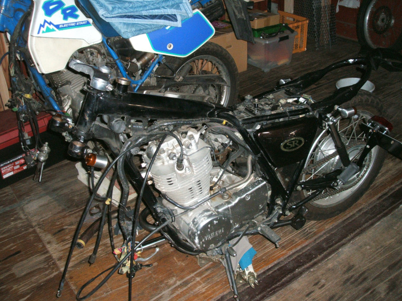

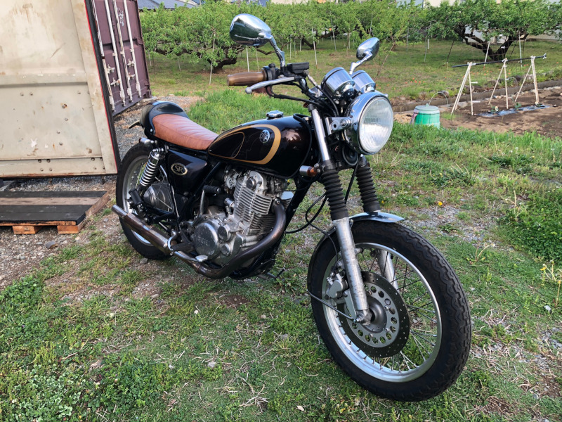

where we started:
anyway, it is what it is, but i wanted to start a new thread on here any way because this is home, and maybe someone will enjoy seeing what i'm working on.
the background:
so a buddy calls me up and tells me his son who is into bikes has this SR400 he bought off the online auctions over here and he wants to see if i'm interested in doing a few custom things to it for him. He brings it by for me to look at and we talk about it, and I agree to help him out (for dang-near free. i mean, he's my buddy's son, he's a young guy who's into bikes and wants some stuff done but doesn't have the tools or knowledge to do it, etc, etc - and i happen to like playing with bikes).
that was a couple of years ago.
along the way, things changed and it became a full-blown build. the young'un has this custom cafe racer built by some guys in England that he just loves, and even though it's not something i'd normally do (imitating someone else's build), i'm helping him build a bike very similar to it.
we're getting in the home stretch now, so i thought i should post up some of what we've done.
I rarely remember to take photos so there's a lot i've missed, and i've probably got the order of some stuff screwed up now, but maybe you'll get the general idea anyway.
HERE WE GO.
where we started:
- IMG_0846.JPEG (166.6 KiB) Viewed 25217 times
- IMG_0847.JPEG (181.3 KiB) Viewed 25217 times

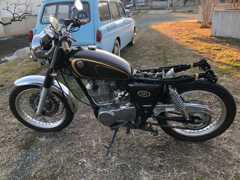

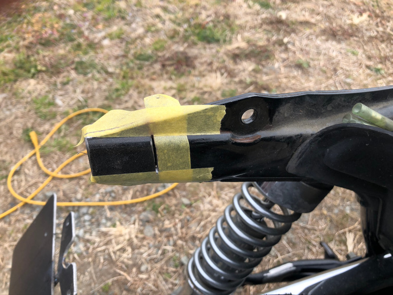

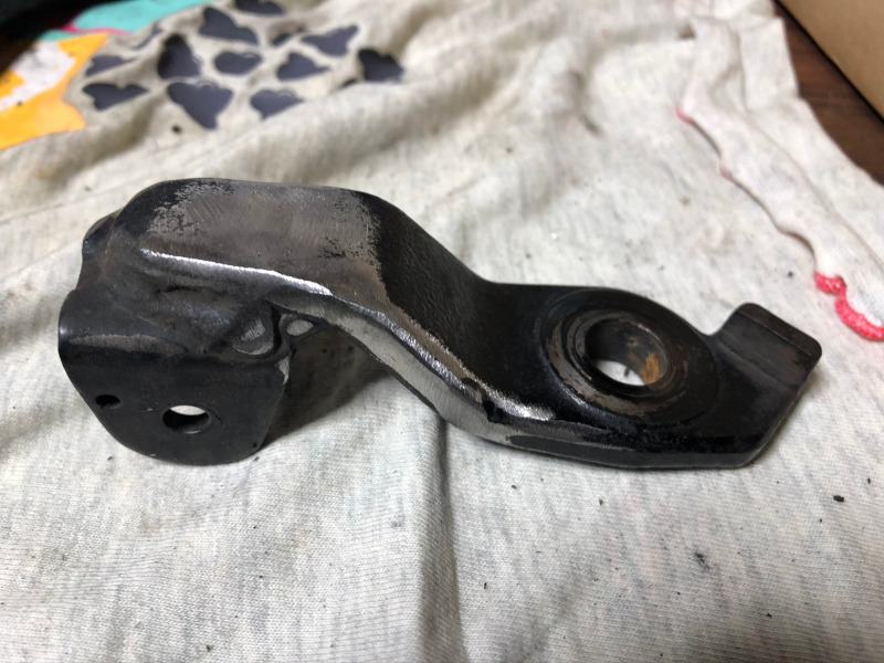

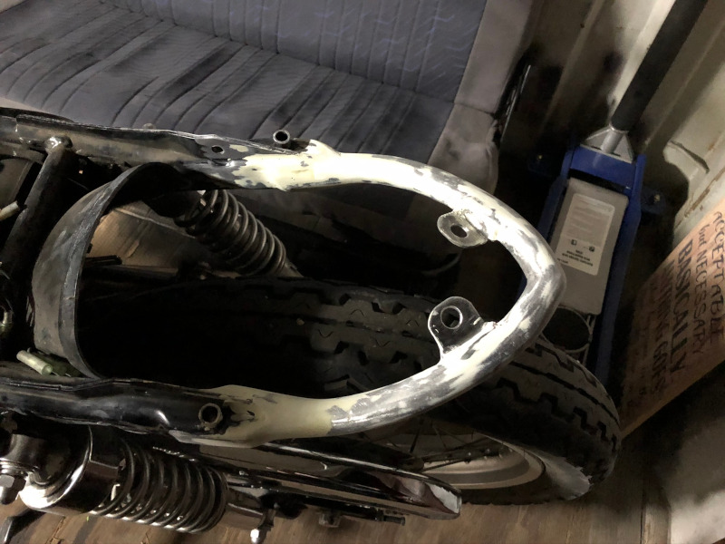

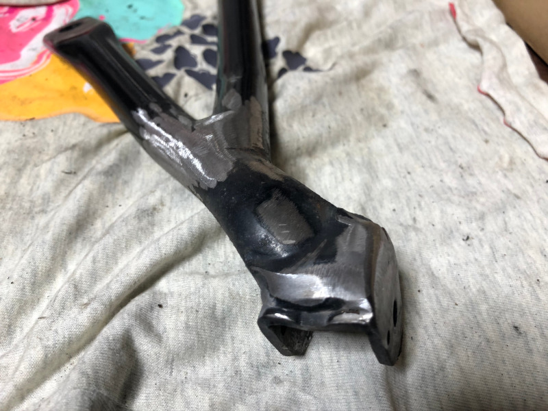

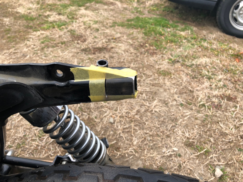

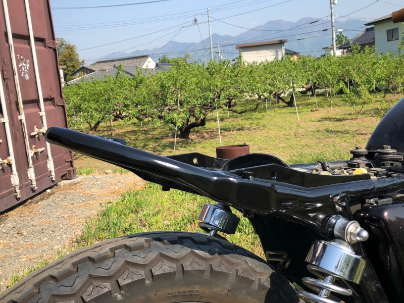

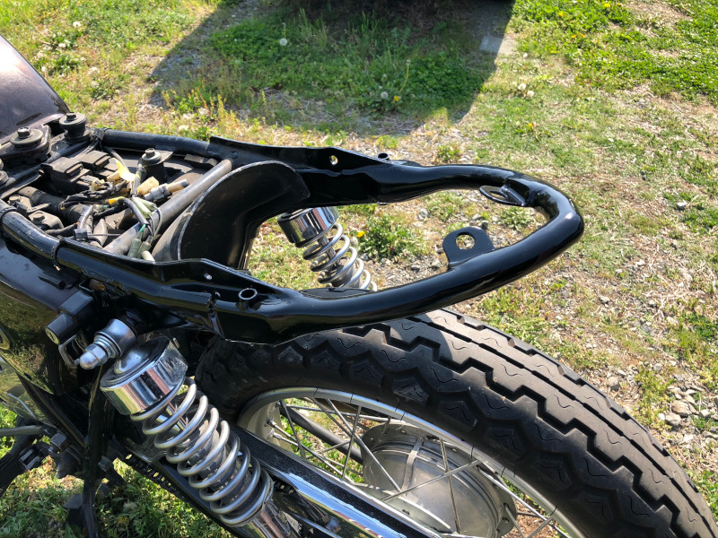

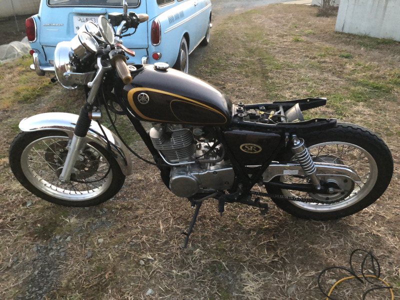

first i lobbed off the rear, cleaned up some of the factory ugliness, and fabbed up a rear loop.
- IMG_0848.jpg (233.03 KiB) Viewed 25216 times
- IMG_0850.JPEG (248.76 KiB) Viewed 25216 times
- IMG_0851.JPEG (156.96 KiB) Viewed 25216 times
- IMG_0852.JPEG (147.88 KiB) Viewed 25216 times
- IMG_0853.JPEG (154.97 KiB) Viewed 25216 times
- IMG_0880.JPEG (206.95 KiB) Viewed 25216 times
- IMG_0881.JPEG (180.23 KiB) Viewed 25216 times
- IMG_0945.JPEG (144.87 KiB) Viewed 25216 times
- IMG_0951.JPEG (298.17 KiB) Viewed 25216 times
- IMG_0952.JPEG (241.72 KiB) Viewed 25216 times

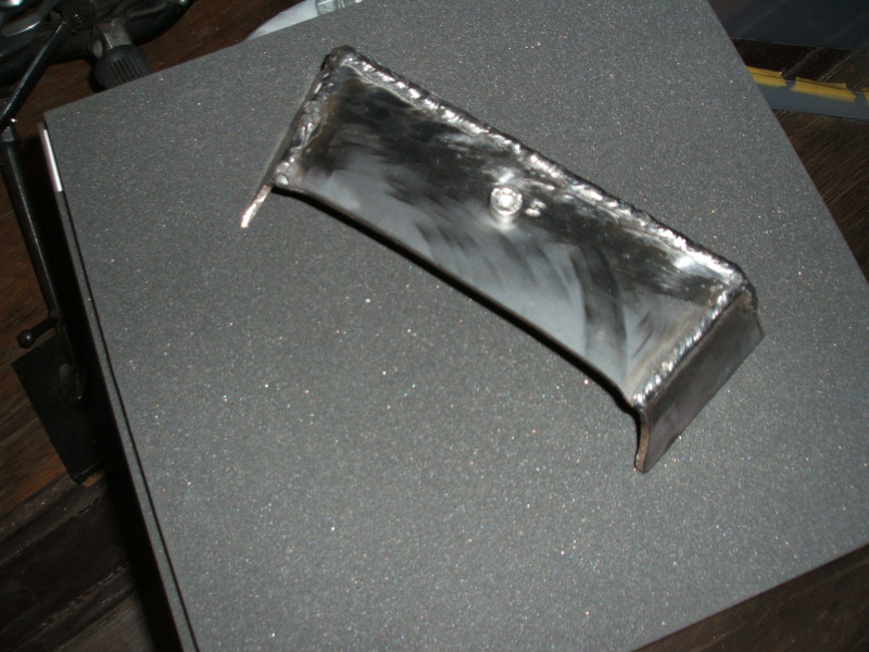

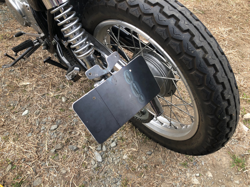

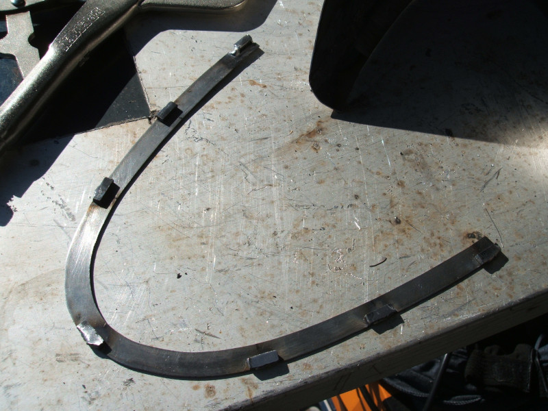

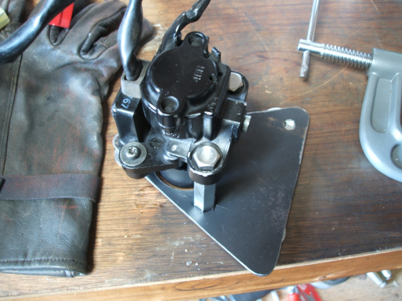

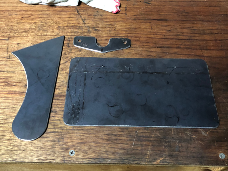

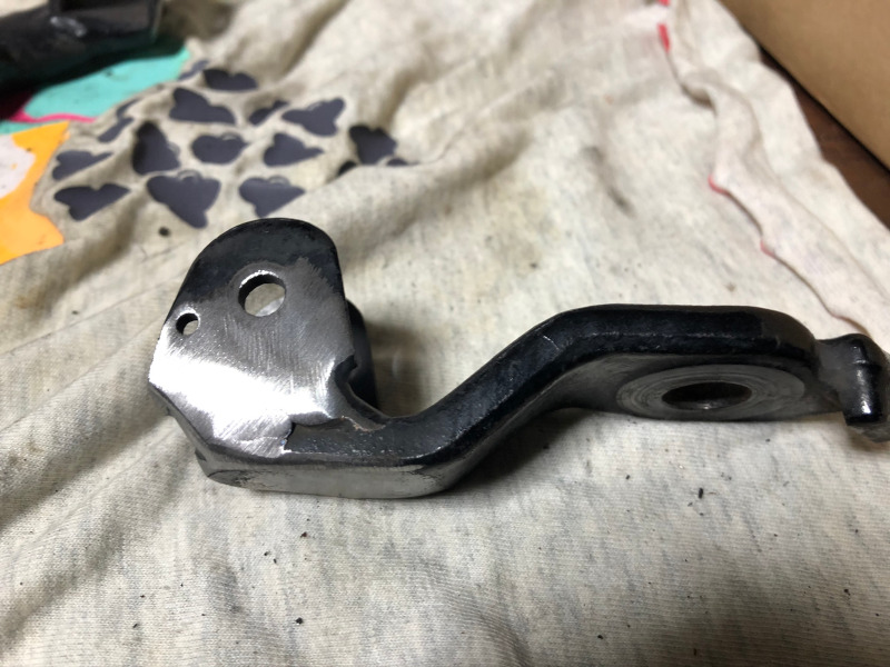

then i set to work on a license plate holder and a plate to move the key switch/immobilizer down to the side cover area.

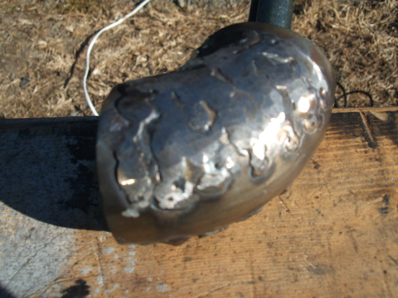

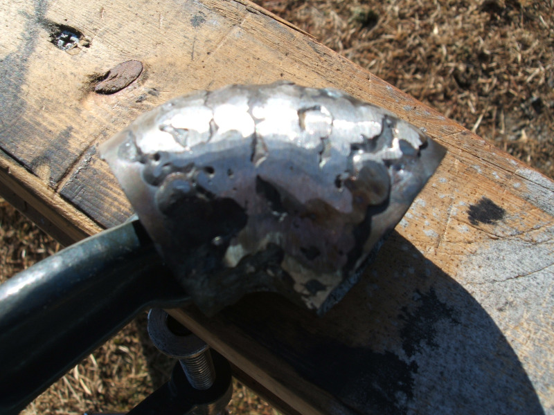

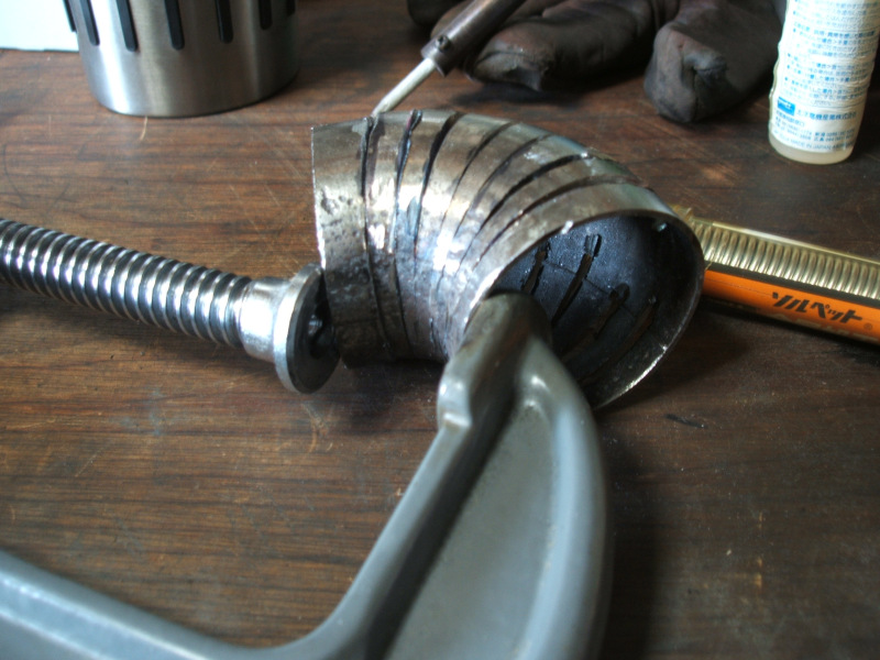

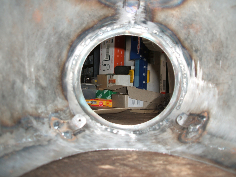

somewhere along the line i made an exhaust pipe with a TIGHT bend coming out of the exhaust port. excuse the booger welds, it'll all come out purty in the end.
trust me.
really.
trust me.
really.

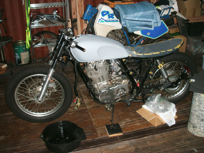

and then the young'un decided he wanted to go all out.
and somehow he convinced me to jump down the rabbit hole with him.
let "phase 2" begin.
- DSCF4051.JPG (213.94 KiB) Viewed 25216 times
Re: SR400 Cafe Racer

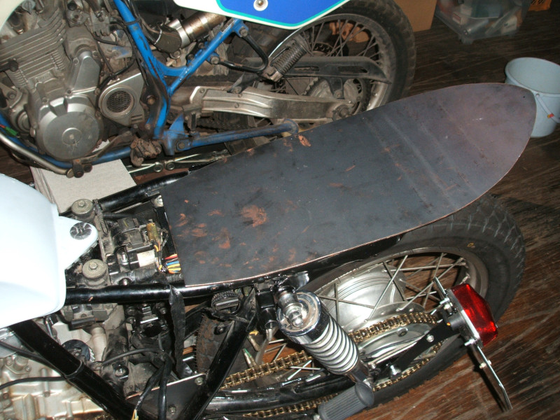

so, like i said, i suck at remembering to take photos, so there's a lot i missed. to make a long story short, the young'un (yes, he has a name, but it amuses my Kentucky sensibilities to call him "young'un") shortened his forks, and I showed him how to make a seat pan. we double-teamed dishing in the sides of his gas tank, and i finished tacking together his exhaust pipe (like 5 times
- DSCF4060.JPG (165.32 KiB) Viewed 25216 times
- DSCF4068.JPG (197.34 KiB) Viewed 25216 times
- DSCF4239.JPG (148.99 KiB) Viewed 25216 times
- DSCF4240.JPG (186.2 KiB) Viewed 25216 times

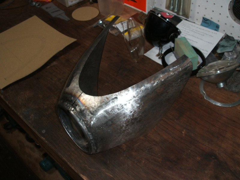

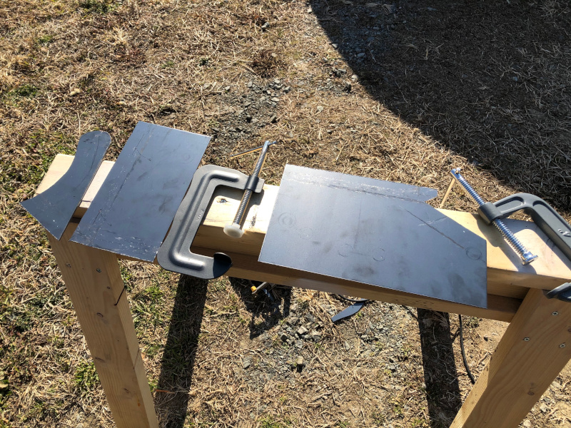

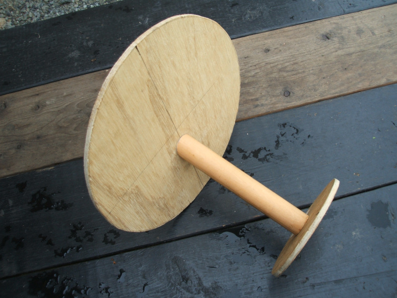

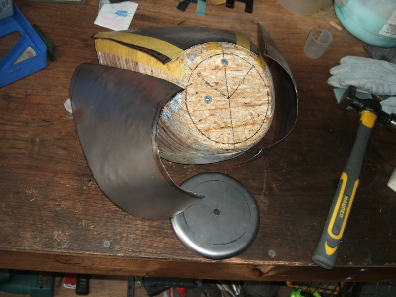

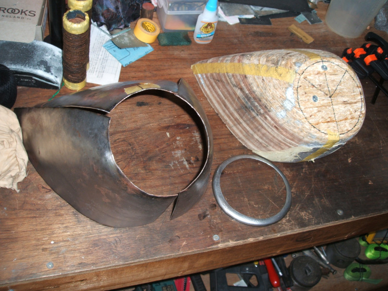

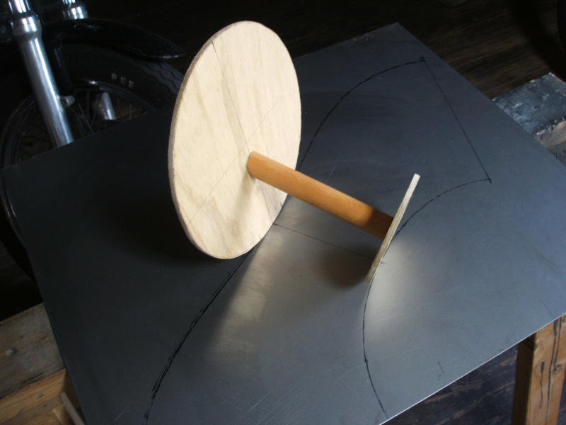

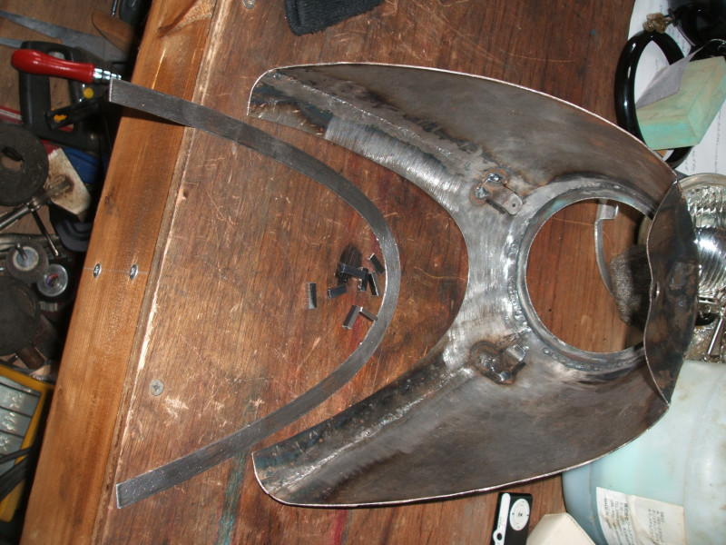

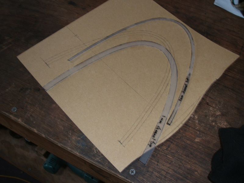

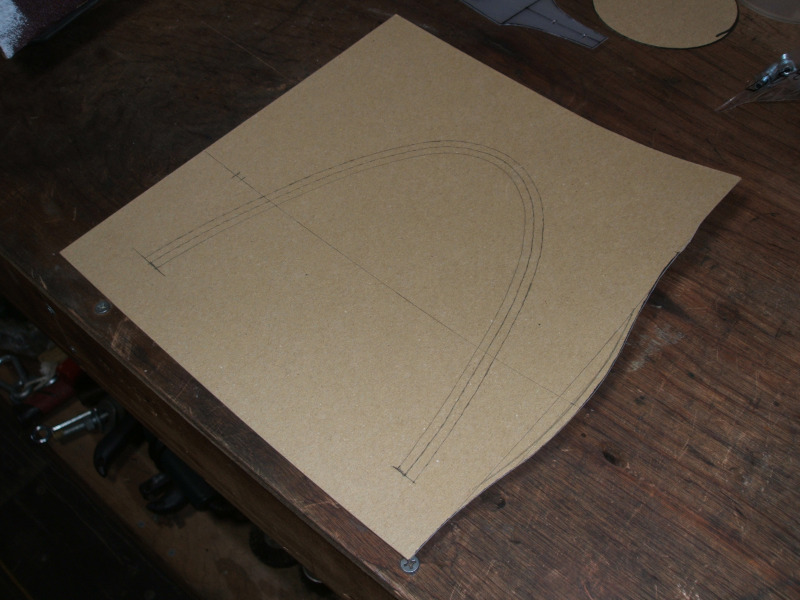

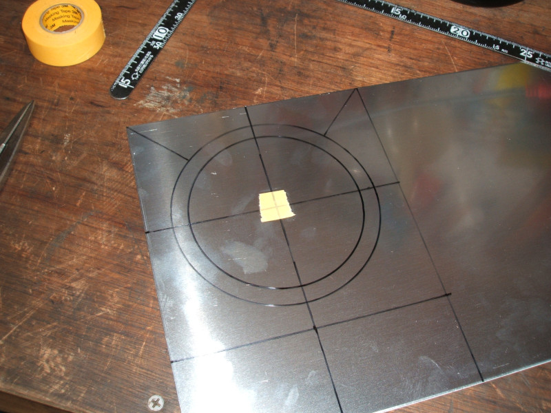

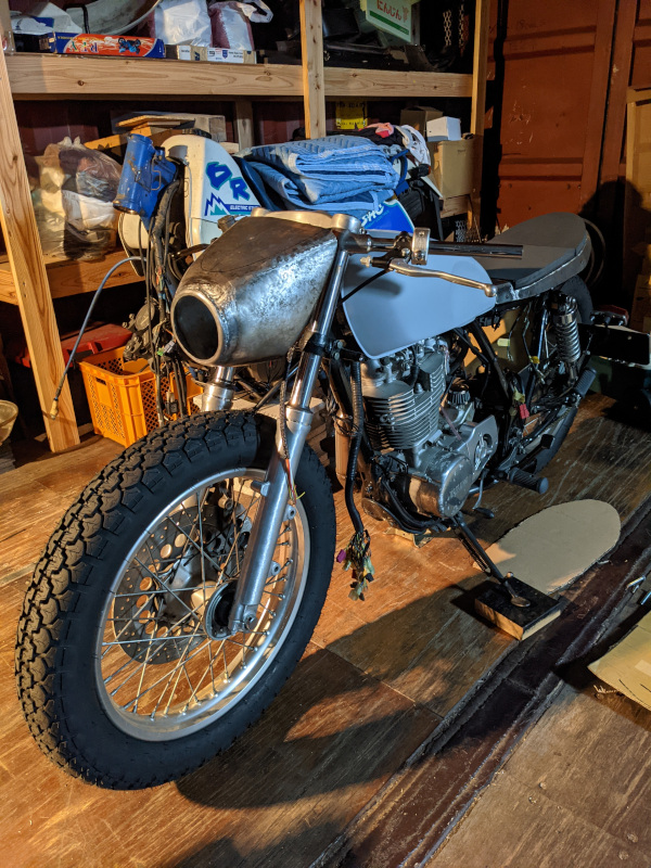

and then i started on the cowl. now, keep in mind that while i've played with plenty of fenders, gas tanks, and the like, i've never beaten out a whole cowl by hand before.
first i made a wooden buck (which you can see in some of the photos). then i made a wooden tool to help me cut the flat sheet metal close to what i needed.
then after a lot of hammering, massaging, and adjusting, i finally got the 4 pieces shaped to make the main shape of the cowl. two sides, the top, and the front ring.
cut out the area for the screen
made tabs and a bracket to hold the headlight in (the bracket will be pop-riveted in place after paint)
and added little tabs to make a channel for a plexiglass screen
and looking better:
and looking better:
