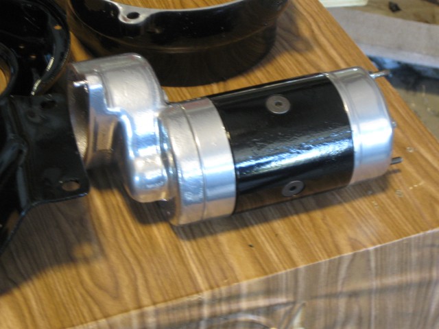

NIC industries have the largest selection of powder coatings bar none. The clear over the chrome is a bummer. For the best results on chrome i have found Prismatics ultra chrome with All Powder Paints clear. Thats as close to chrome that I have ever gotten
- Harley starter
- 122 (Small).JPG (77.45 KiB) Viewed 51165 times
