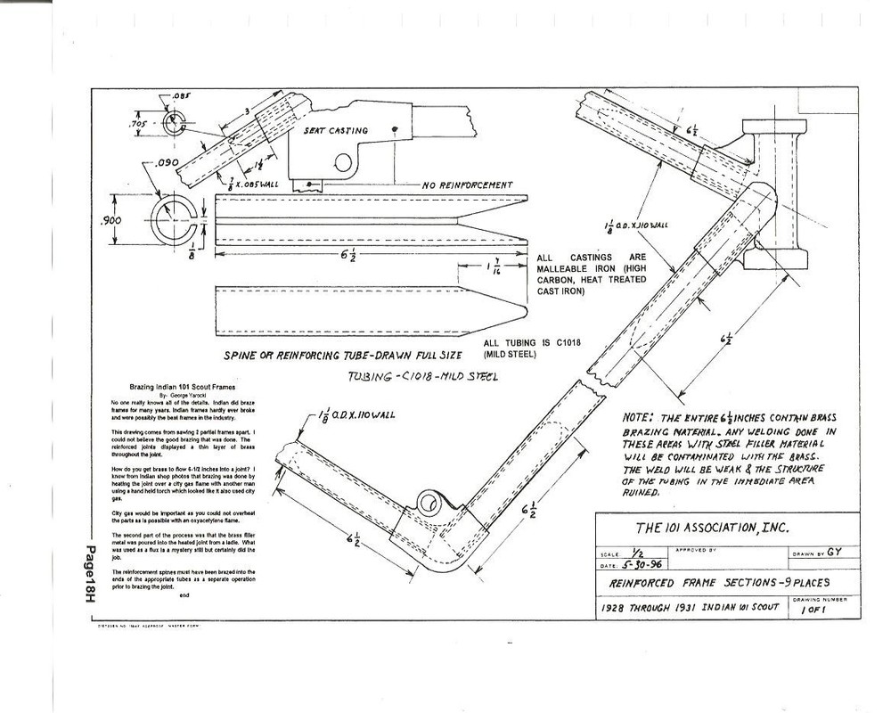

Yea its not the whole frame . I measured off the paper version , the scan version plays with my eyes
this is the same neck cast as early short frame scout = corrections made to list
fork rake is 25*
rake axis to down tubes = 45*
down tubes to top rail = 70*
top rail to rake axis = 65*
down tubes = 20*
rear top legs = 30*
45 + 70 + 65 = 180*
45 - 25 = 20*
they reakon the 101 was the best handling Indian
fork rake is 25*
down tubes = 20*
rear top legs = 30*
45 + 70 + 65 = 180*
45 - 25 = 20*

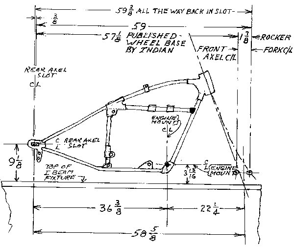

another pic of wheel base .
at some stage Ill get frame measurements. Theres no info on the net = hold outs!
- 101framesketch2.jpg (60.89 KiB) Viewed 24553 times

this is relevant to 101 geometry as the first pic at top of page has top leg sloping at 30 degree , the V.I blueprint has axle plate at 50 degree and my frame is 20 degree on the lower leg bend and 20 degree being the diff between 50 and 30.
the 2nd pic of 101 frame shows measurement from axle slot to motor mount etc

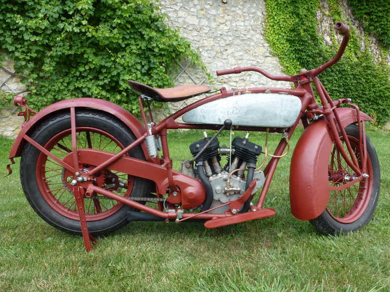

Pic = 1927 police special used early scout frame geometry with 101 style thru bolt mount , the axle plate is the first to have side car hoops like 101
1925 = 11.4295" long x 3.525" high , centre pedastal mount holes to centre trans mount hole
101 = 15.15625" long x 3.150" high , centre thru bolt mount hole to cetre trans mount hole
these measurements are MINUS the 4 x shims that go between trans and motor , S2205 = 20B797 , .003" shim OR S2205A = 20B798 , .005" shim
on the V.I blueprint chief legion frame
1944 chief = 15.3129" long x 2.8125" high , according to Legion frame = http://virtualindian.org/9newslegionpic1.htm
this is relevant to 101 chout = chief motor in scout frame
- img_1.jpg (87.85 KiB) Viewed 24502 times
