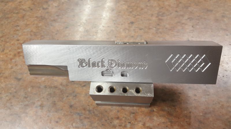

Finally had a chance to dabble with the slide. Cut the ejection port, misc lettering and the notches on the left side today. Hoping to put in the holes for the extractor and the firing pin tomorrow. We'll see how that goes.

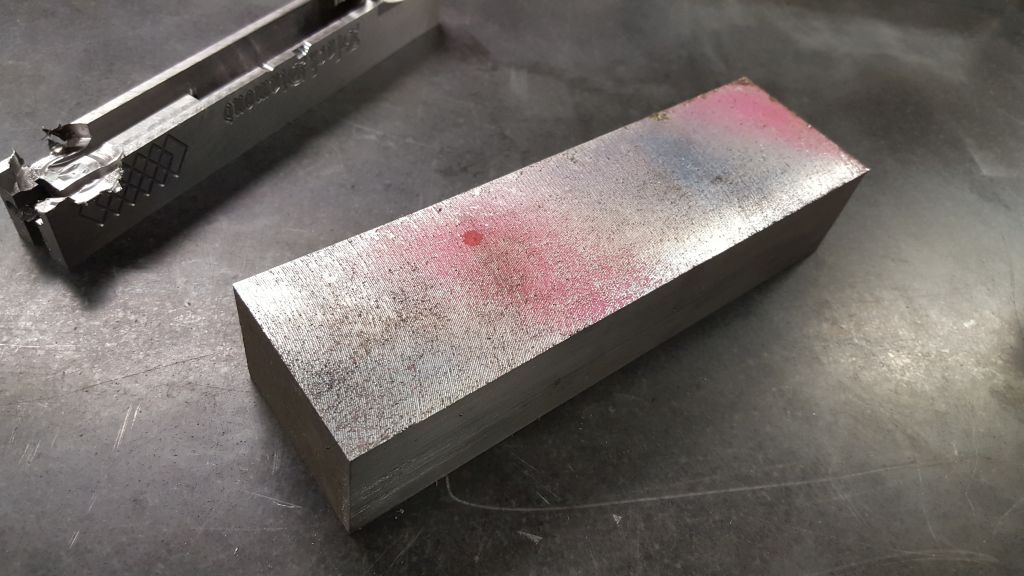

I spent most of yesterday working on this thing. I figured if I didn't get right on it I might just surrender in defeat. It'll probably be at least a few weeks before I can do more on it as I'm falling behind on my actual work.

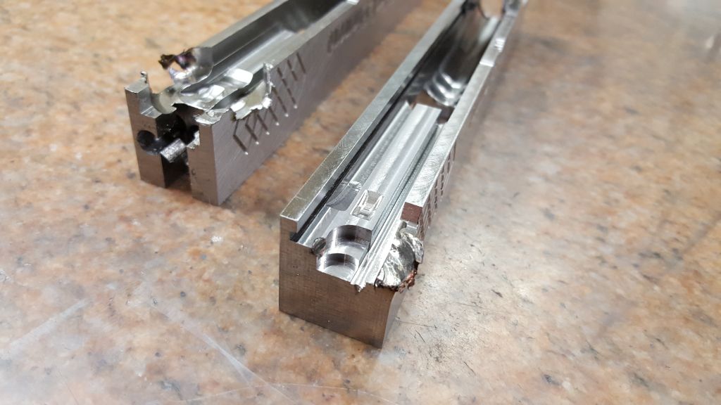

I finally got some time to get back to this thing. I cut the ejection port on the top, engraved the sides, then machined out what I could on the inside. Then I cut the slot. It's still to tight, but better than too loose. I'll get it back in the cnc and fit it to the receiver.

SONOFABITCH! I crashed the cnc again. Almost the same area. I screw up on a somewhat regular occasion, but I almost never crash the machine. I bought this particular Haas cnc brand new in 2000. I can only remember 4 times actually crashing metal into metal. TWICE on this friggin slide project!! UGGH very frustrating. Anyway, I think it can be fixed. I'll keep you posted. In the mean time I've fallen behind on my real work.
