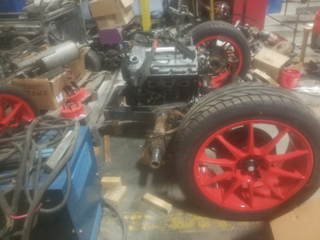

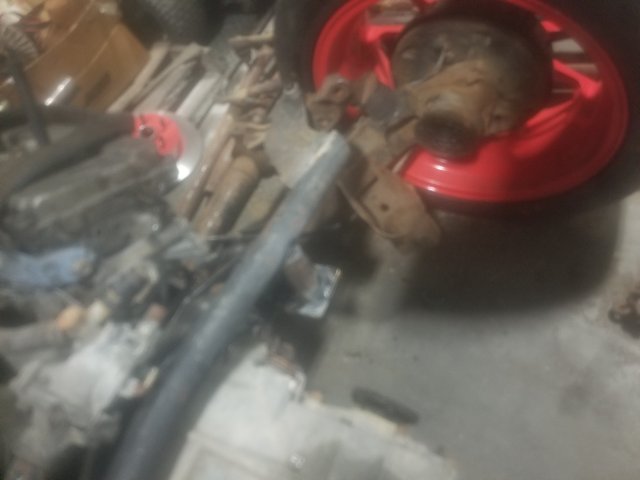

More mock ups of rear frame and suspension.
A full 13 degree angle on the axles at bottom out.....which is all a type 1 cv joint will handle.

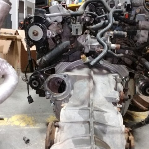

I made up the "front" engine mount attachment using the original rubber mount on the engine that was attached to the fender well of the donor car.
Then got the elephant ears located and tacked down too.
Also worked up the rear cross member that ties together the back of the notch and the shock towers.

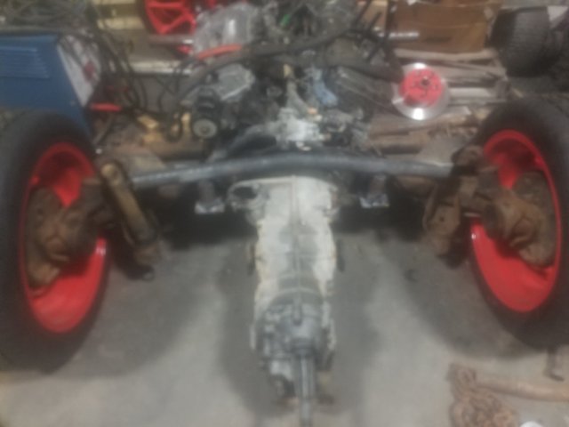

That is a VW gearbox I have been using for mock up purpose.
But I did go get the Porsche 901 side shifter trans.
I will probably open it up to check things out.
It was in a running functional car.....until the car got wrecked.

I will probably have to make a flywheel.
But I would like to use the mazda clutch if I can get it into the bell housing.
So next is getting the trans fitted up and making the rear most sub frame to hold the tail of trans, radiator and hood hinge.

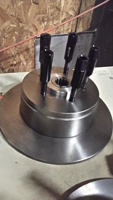

Post by DeathBySnuSnu »
STOP NOW.

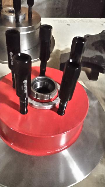

All the disc brakes made up.
Had to get them "blank".....as in not finish machined.
Then I had to make them fit my metric Enkie wheels.
So....all sleeved and bolt patterned.

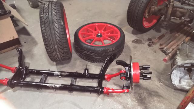

Front beam going back together.

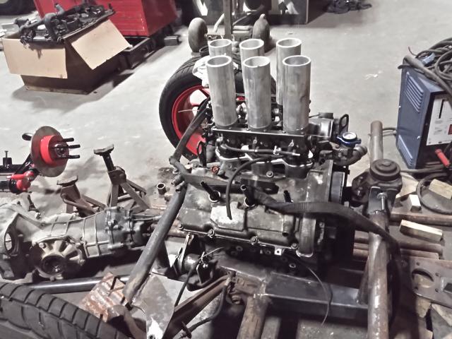

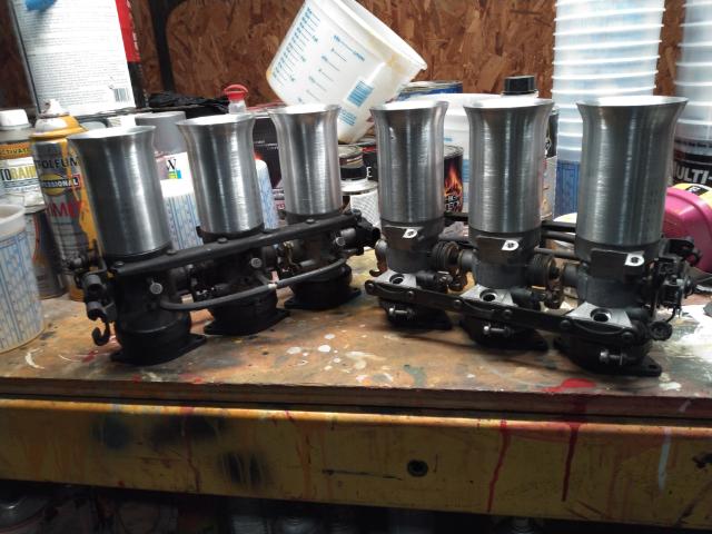

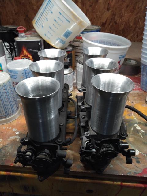

All the intake manifold parts made from throttle body down.
Not welded yet......buy working on turning the chunks of metal on top into stacks.

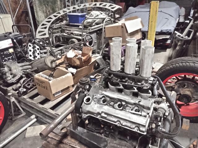

Chunks of metal are now stacks.

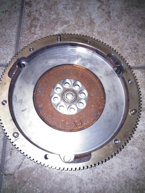

And this will be a flywheel.

Half Mazda and half VW flywheel.

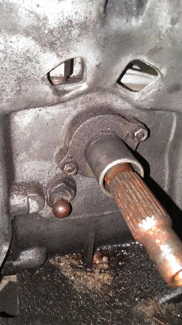

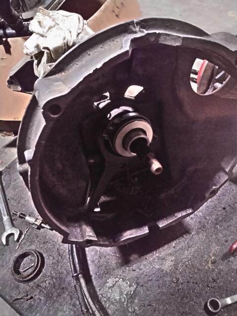

And the custom sleeve for the 901 trans to put a type 5 throw out bearing in it....with a modified 901 fork.
