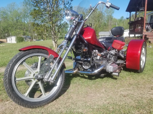

Re: Front engined VW
It went on its first test ride this evening.
Lots and lots of tuning yet to go.
But it is an arm stretcher already.
The drop pivot linked shocker front end seems to work.
Stable and controllable. Not twitchy at all with very low trail.
Less than an inch.
Less than an inch.

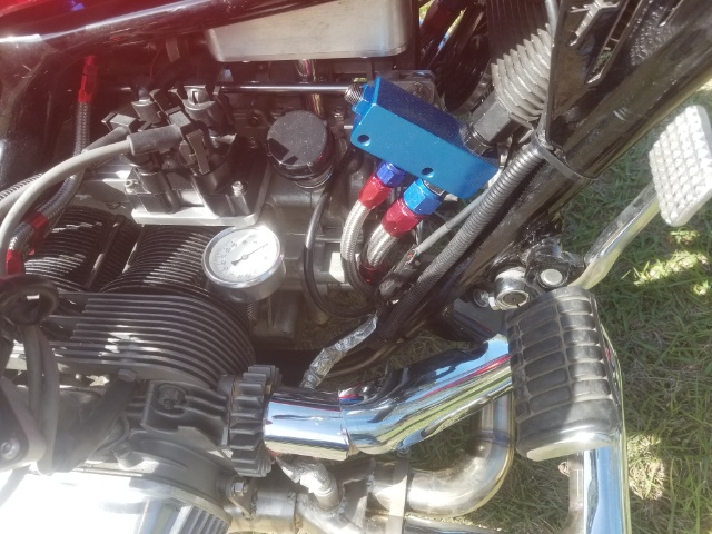

Then I started tuning on the headers.
Wow....what a difference.....I no longer have an off cam rpm.
Ridiculous begins right above idle and goes to 7500....all before you know what to do with it.
It has been registered for a long time.
The rules are state by state......my state is very lax.
It is what is stamped on the neck.....period.
I was required to stamp the engine as it is a replacement and had no number.
So it is a numbers matching 1985 Honda goldwing and is a registered and documented antique with permanent plates. No more taxes or inspections. No restrictions no mileage limits.
It made some hp.
And broke the trans in third gear.
The trans is built....should hold 200hp....but I did around 225 at the crank. Something is going on with 3-4 hub. Gears are still there. But not shifting right and syncros dont work. No gear whine but all loose and clunky like backlash. Just checked the shaft end but and is tight and shaft not moving in- out. So I am guessing a thrust bearing inside.
Will be pulling trans back down soon.
It made some hp.
So what it was.....
The aftermarket hub and slider on 3-4 deformed a bit. With the hub out of round the slider did not line up with the synchro. I broke the brass sychro rings continuing to drive it.
Now I am told that an original German hub is better and use the aftermarket slider.
So it all went back together with used parts.
And I am back in the wind.
No more full throttle dyno pulls for me. It is easier to accelerate the bike than the dyno.
So.....
I lost a couple reply post in the site down time. No biggie.
The scooter has been running a while now. Some interesting developments though.
I finished (put the end cone on) the reversion can on the collector. I had left it open.....well.....cuz it sounded cool.
But good gawd what a difference that made. I doubt the peak hp is any different but getting there has gotten a lot more fun.
I am running a 270 @.050 cam so it dont come in until around 3000 to 3500 rpm. With the cans it now pulls hard off cam. You can sport around banging gears and an occasional wheelie all day long without ever even getting to the cam turn on point. And then on cam it is still a power house screamer. The thing sounds way more like a motorcycle than a v dub.
I went to a bike rally and it was popular to look at....but overall they did not have a clue what all went into it.
I have been to a couple hot rod car rally's and them guys understand what all it is.
My friends get a kick out of me trying to explain it.....lol
