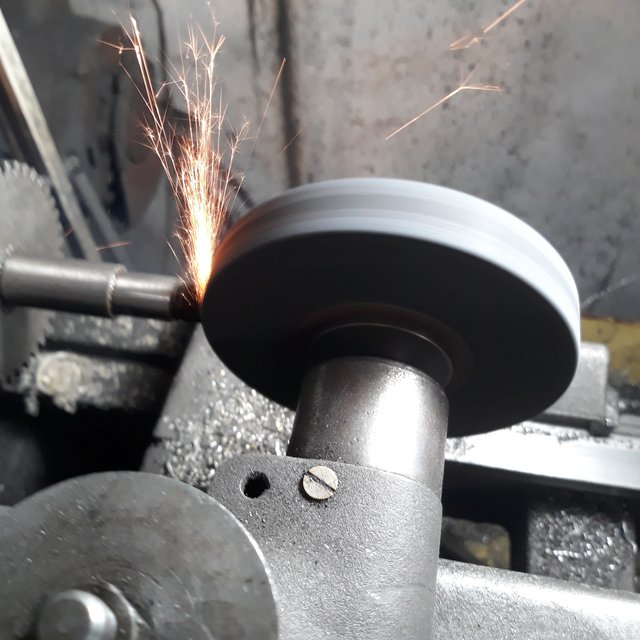

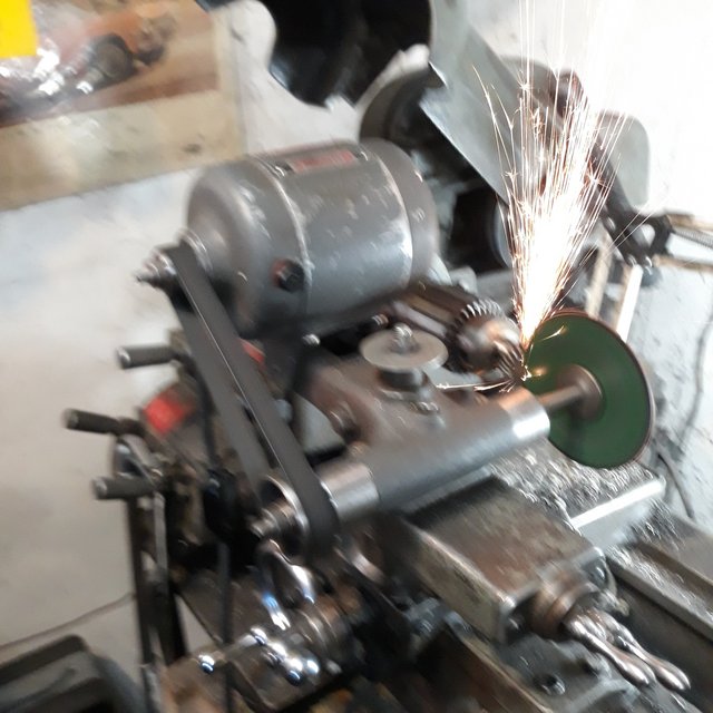

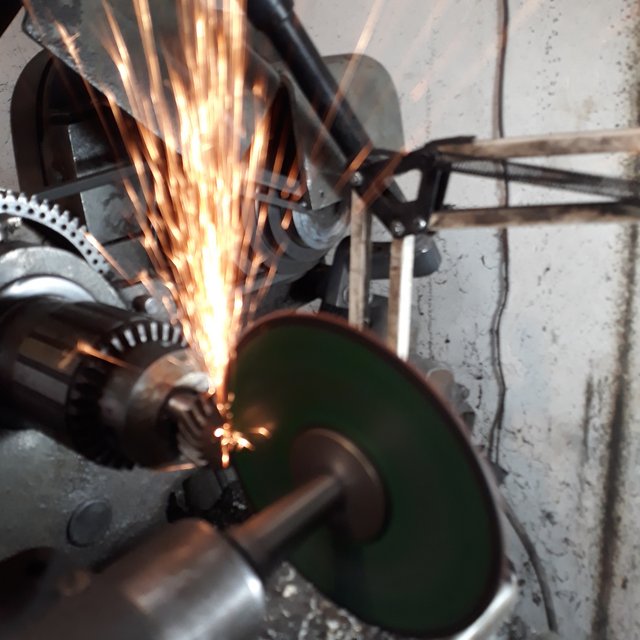

Started slotting the drive gear on the sporty pump. Strangest setup I've ever made. An end mill would polish it a little This was actually pretty quick. I started grinding the teeth off and something broke in the lathe power feed so I'm headed in the lathe repaiir direction next.
Presto a .170" X .330" slot.

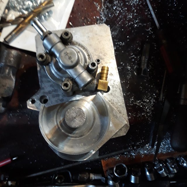

I now have a Sportster oil pump that drives by a slot and tang.

Got the drive tabs ground onto the cams and the cams in place hopefully for a while. As far as I can on the adapter until I can until the timer is built and I just started making the shaft. If I was going to do anything with the bike other than race at Bonneville I would either shorten the pump or drive it with a worm gear and hang it to the bottom like the Sporty it came off of.

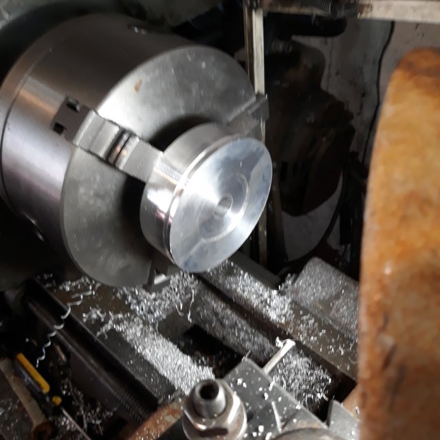

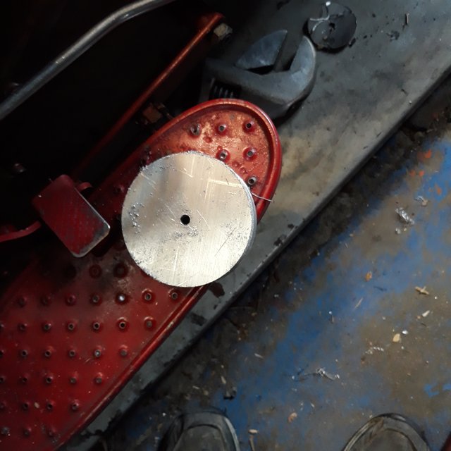

A piece of 1" plate from the scrapyard and some quality time with a hole saw yielded this blank
A little time going in a circle yielded the basic shape.

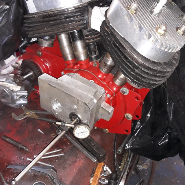

Centering the A-dapter plates (as Johnny Cash said). Once they are centered I'll drill holes for the pins that will keep everything straight.
Re: Dusty's Bonneville Scout Build

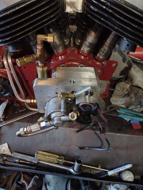

Getting a little closer to shape. The timer rides on the outer bearing race that sets proud of the adapter with a slot and guide plate on the outside The reluctor mounting plates that allow each reluctor to be time seperately are made but the photo didn't come out.

Got the timer mostly done today, I still need to set the timing with a meter on the pickups they are just visually aligned right now.

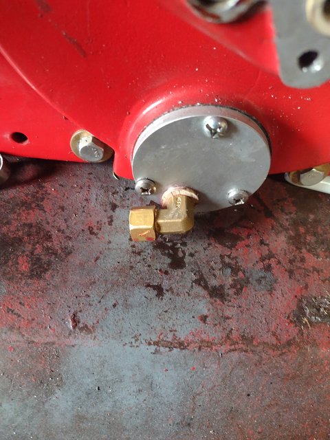

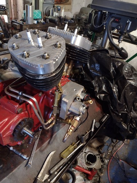

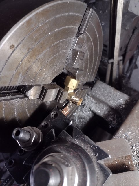

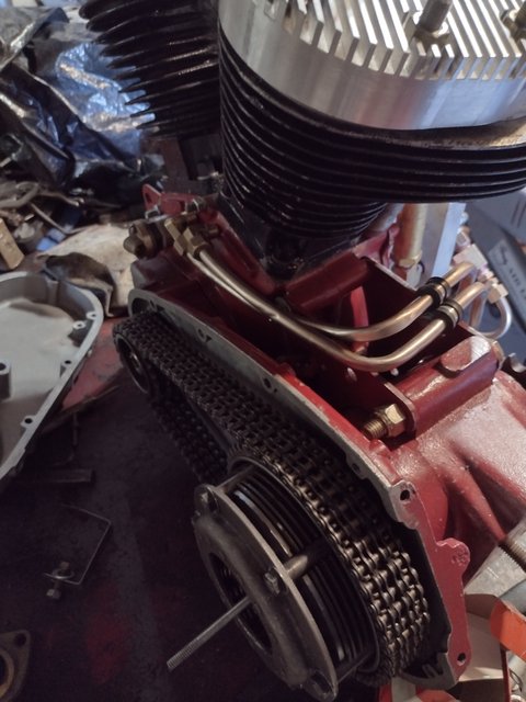

Cut some 1/4 pipe fittings down to 7/16"-24pti straight threads
Then started running 3/8" nickel copper lines.
