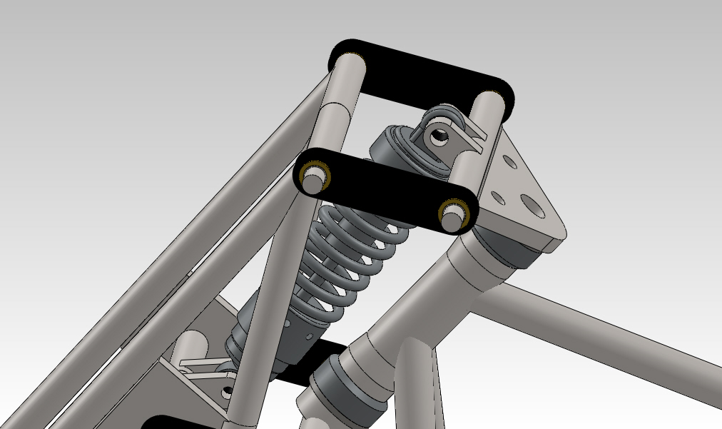

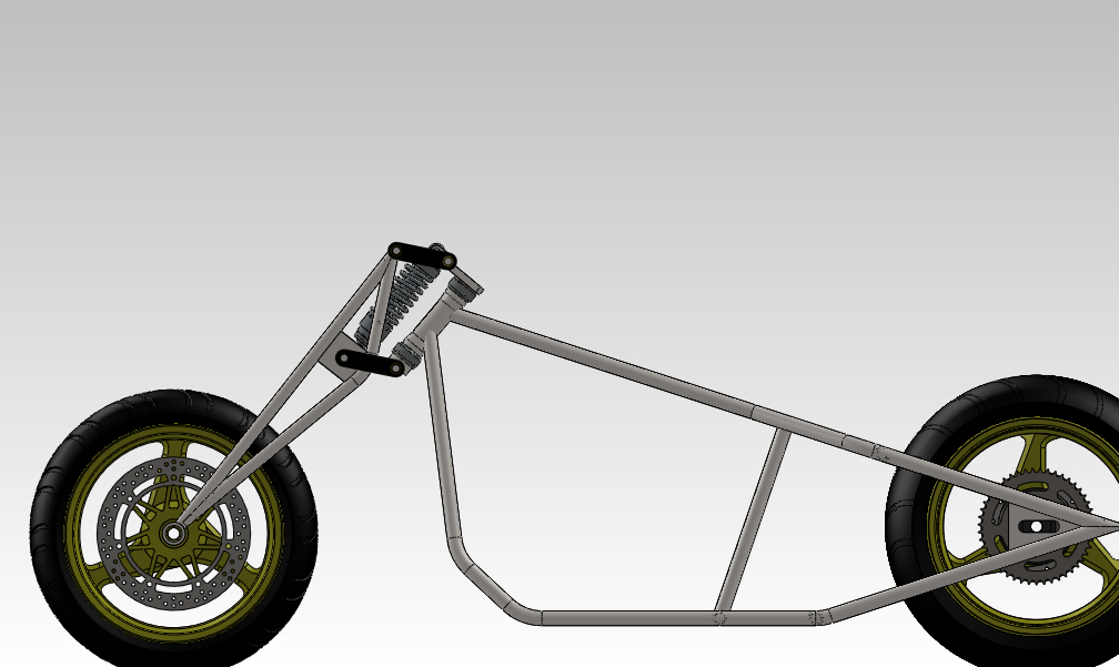

Ok guys, I was finally able to came away with the solution showed below for my frame and its front end.
The frame will accomodate a 4 in-line, 600cc Yamaha unit engine (I will have to replace the airbox with some filter cones to avoid interference with the backbone, but that shouldn't be a problem... :roll: )
The wheels are stolen from a Kawasazi ZX 12-R (200/50 rear tyre).
The girder's shock is a rear shock from an Honda Rebel 250.
General dimensions (in millimeters, I've already converted them below for you imperial guys and for blonde, sweet girls off course... :mrgreen: ) :
Choppa 2 Dimensions.JPG (163.06 KiB) Viewed 13570 times
Rake: 40°
Trail: 77.88mm [3.06"]
Neck Height (measured from the right end of the lower cup, as in Gary's drawing): 642.03mm [25.27"]
Ground clearence: 108.64mm [4.27"]
Front axle height: 300mm [11.81"]
Rear axle height: 315mm [12.40"]
Wheel base: 1796.94 [70.74"]
Girder length: 750mm [29.52"]
Girder links length from center to center: 110mm [4.3"]
Some girder's shots:
Girder - Top 1.JPG (129.18 KiB) Viewed 13570 times
Girder - Top 2.JPG (129.1 KiB) Viewed 13570 times
Girder - Top 3.JPG (156.64 KiB) Viewed 13570 times
Girder - Bottom 2.JPG (131.63 KiB) Viewed 13570 times

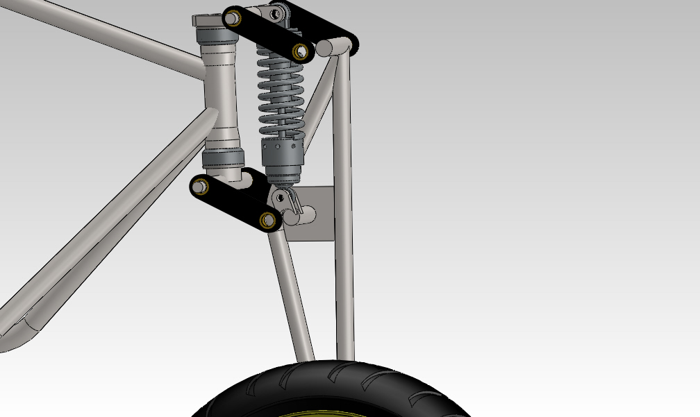

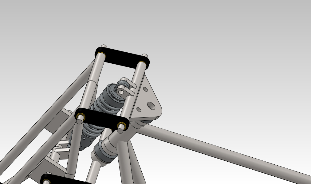

As you can see the girder is a little bit on the stubby side, but I had to make it much shorter (8.5") compared to Gary's one to get an acceptable positive trail, while maintaining the links at a reasonable angle with the ground (between 10°-12°).
I've checked for interferences and I shouldn't have problems; the rest of the measurment are all in the recommended ranges, I suppose.
My only question is about the lower shock mounts position: is it ok to have them pointing up as you can see in the last two pictures, or do they need to be at right angle with the girder's front (straight) leg?
Many thanks and feel free to let me know if you see something that seems wrong in the whole assembly.. :pray:

It looks good to me. The angle of the shock is oaky as well but from an appearance standpoint it might look better if it was parallel with the angle of the front legs as long as there is no clearance issues.

I could make the shock sit almost parallel to the neck and the girder's front leg by shortening the lower mounts:
Girder Shock Parallel.JPG (165.67 KiB) Viewed 13565 times
I didn't do that for 2 reasons, the first is that doing this way the mounts would point even more upwards, and I wasn't sure if this would have been a problem (it seems it isn't, if I understand correctly...):
Girder Shock Parallel 2.JPG (114.9 KiB) Viewed 13565 times
and the second one is that in this configuration the mount is long 30mm (1.18") center-to-center, and in your plans you called for 1.375" min for this distance (yes, I got all your stuff from Bitter End Choppers and went through it I don't know how many times now.. :roll: ); but maybe even this shouldn't be an issue, because probably your recomendation was specifically conceived for that particular girder, isn't it?
In this case I will go with this second configuration for sure...

Re: My girder & frame project - Anything blatantly wrong?
In my opinion, Gary is the ultimate authority here, but just a quick comment for clarity.
The lower shock mount connects to the fork member between the front attachment points of the lower links.
The movement of the lower links (and the member between them) provides the force that actuates the shock.
It follows that the lower mount attached to the cross member moves the same as they do.
For that reason, the position of the lower mount does not affect the function, only the looks.
If there were no interference, it could be on the bottom, and make no difference in the function.
This is my view of it, but if someone sees something wrong with my description, by all means, chime in
