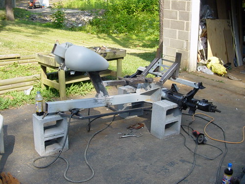

Re: noteson trike building
Stanndard ol' VW tirke building.
NSFM
NSFM
- Still stuck in VW land
- IMGP0663.JPG (135.25 KiB) Viewed 9927 times
Vother shot of frame in early stage.
NSFM
NSFM
- fm8.jpg (90.38 KiB) Viewed 9927 times

I found a set of 12" wide steel chrome rims with a VW bolt pattern.
Kinda wide at the back. (real wide) and tis long.
NSFM
Shot of the back,,note GM 1 wire alternator xonversion,
NSFM
wow, that trike is sweet, and i see you like Dodges too. by all means, do proceed!!!
