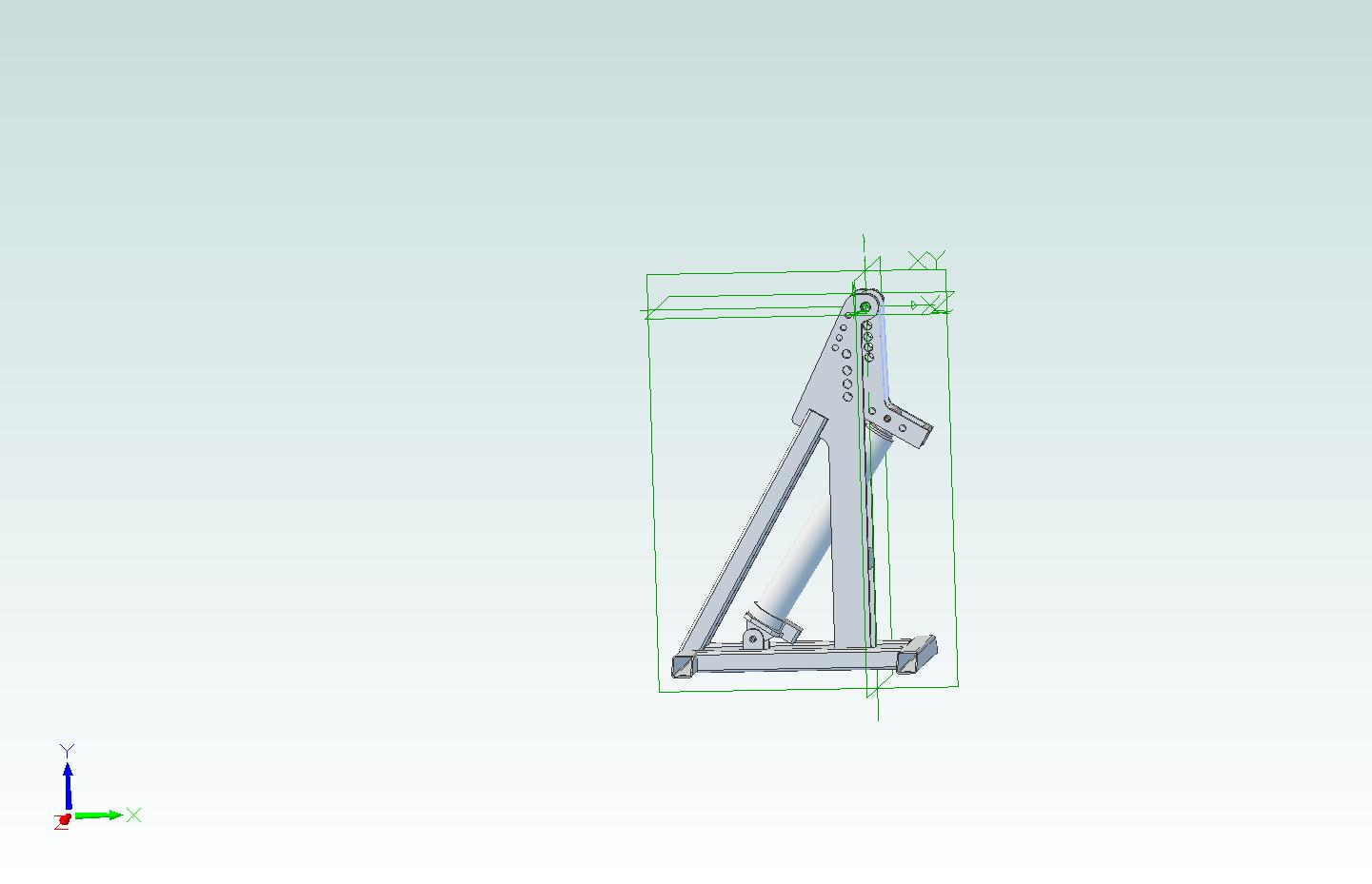

My son and I are building a tube bender to facilitate an SCCA cage fab. We will be using JD2 M32 dies for this project. We need the hole location dimensions for the back block pivots in the main frame which are 1 1/4 inch diameter. This bender is an upgrade to the CBH design to use the Model32 dies.

Here is what we are working on.

Thank you for your reply. I need the position of the 1 1/4" diameter holes in relation to the main pivot hole.
1) distance that the holes are offset
2) distance down to the first hole
3) distance down to the last hole
Your help is greatly appreciated

Using what you gave me this is what I have.

There is 7 position holes in the arm your print only has 6?
I double checked it the print looks right?
You want i can do out side to out side measurements moving the pins around?
![Image](http://i.imgur.com/irERzfpl.jpg)

5.20 - 1.25 = 3.95
The offset must be off in the print causing the .020 difference?

Could you please measure over the last hole and the pivot pin.
Thanks again

This has to be what it is.
![Image](http://i.imgur.com/AtLFe4gl.png)
direct link to image
if you need the cad file i can get a link for you?

Perfect thank you again.
I hope to send the files out tomorrow.
