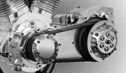

Arrived last week;
Open primary , 6 speed trany, spoke wheels, Starter.
