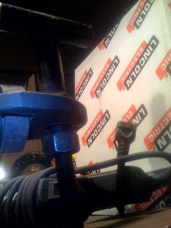

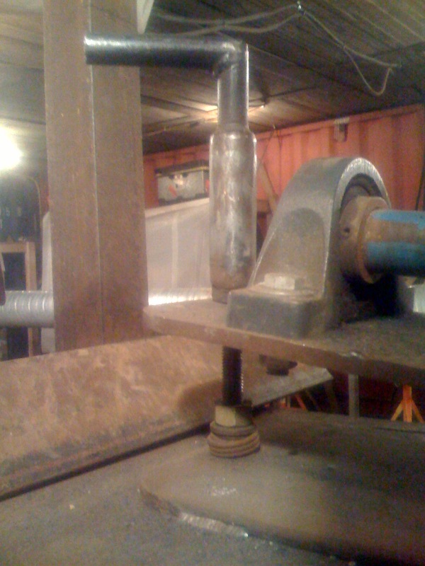

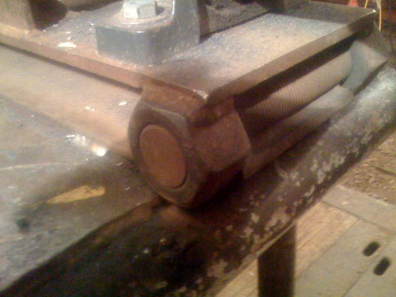

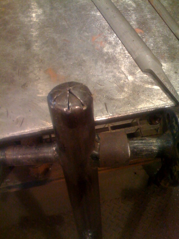

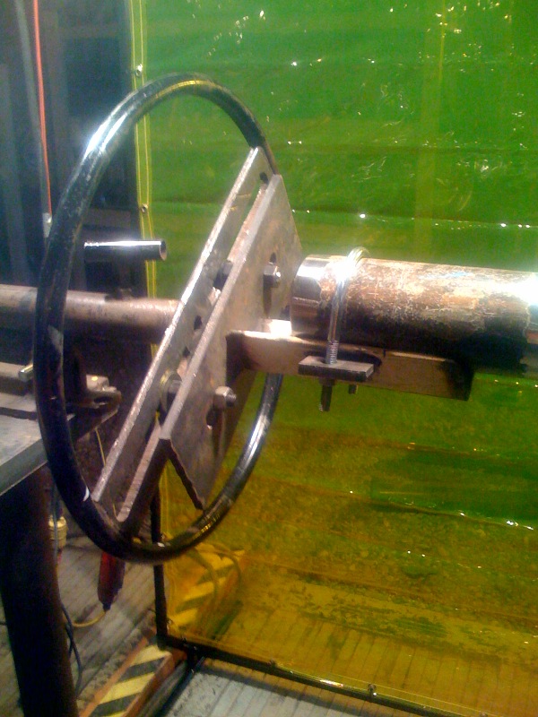

Re: Fixtures for welding tables
On the fixture above you can see the swivel, or hinge, and a level adjuster with locknut on the other end. There is also a clamp above the hinge area, to clamp the pipe insert.
The level adjuster is made from all thread welded to the base.
The steel plate on the bottom is called a strongback, used to stiffen the fixture.
The 3rd pic shows the turntable inserted into the fixture and clamped.
In the 5th pic, you can see a pipe extending below the corner of the table. The fixture has a smaller pipe inserted into that and is clamped in place while working, or can be removed.
The small vertical tube was tack welded for a temporary rod holder.
Edit: forgot to mention the work holder inserted into the fixture. Built on-site, it is welded to a pipe which has been sized to fit into the fixture, and can be rotated and clamped to allow easy access for welding a part. The flat plate has slotted holes for easy bolt up of the work piece.

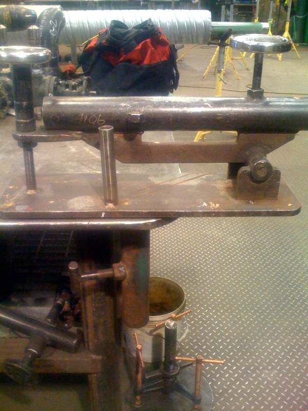

Here is a similar style, built with different materials. This one is welded to the table and uses bearings for the turntable rotation. Bearings are mounted to a plate which is hinged and has a level adjuster.
