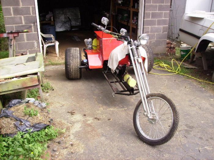

Re: noteson trike building
Post by Fat Mike »
Stanndard ol' VW tirke building.
NSFM
Still stuck in VW land
If it has two wheels---trike it.
Post by Fat Mike »
I found a set of 12" wide steel chrome rims with a VW bolt pattern.
Kinda wide at the back. (real wide) and tis long. :drool:
NSFM
Post by Fat Mike »
Shot of the back,,note GM 1 wire alternator xonversion,
NSFM
