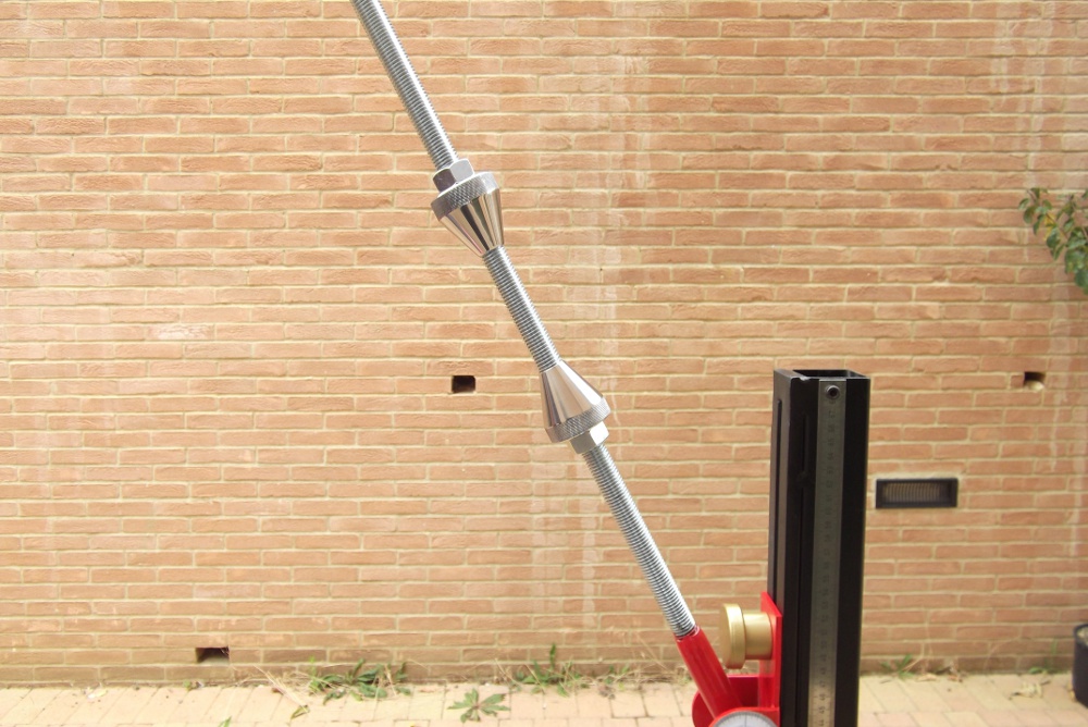

Don't remermber if I had already posted these on the old board, so I'll post them again anyway...
The jig, Crime Scene Choppers style, plus some "racing" stickers, ohh yeeahh! :mrgreen:

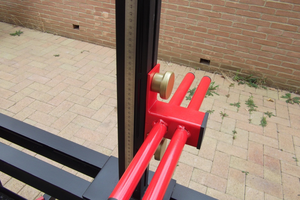

Neck holder:
Neck Holder.JPG (237.73 KiB) Viewed 26274 times

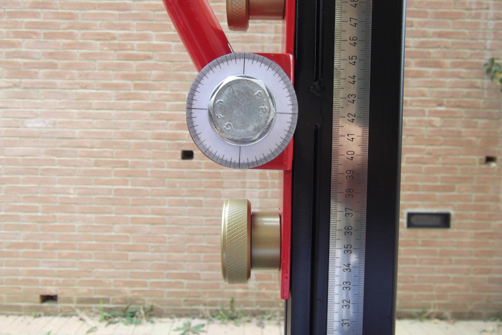

Rake protractor detail:
Rake Protractor.JPG (189.05 KiB) Viewed 26274 times

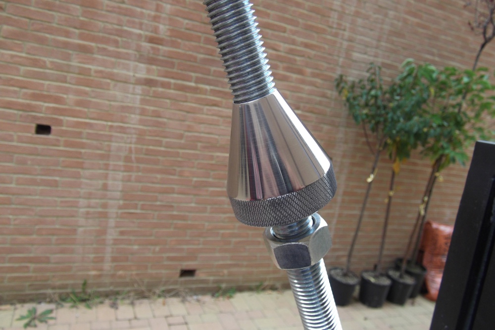

Cone detail:
Lower Cone.JPG (193.1 KiB) Viewed 26274 times

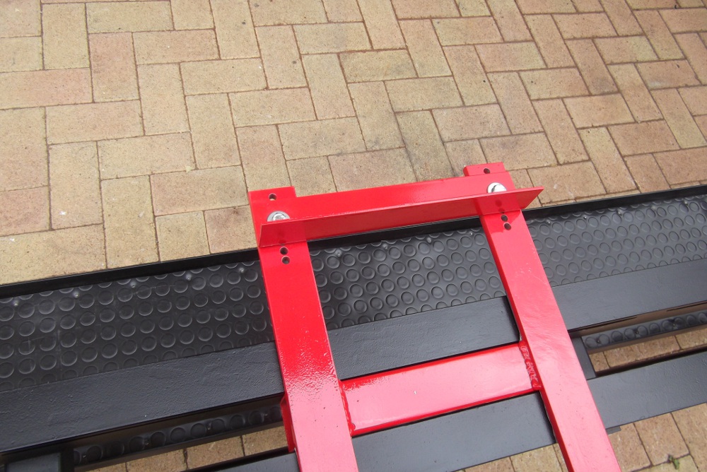

Lower rails sled:
Rails Sled.JPG (242.53 KiB) Viewed 26274 times

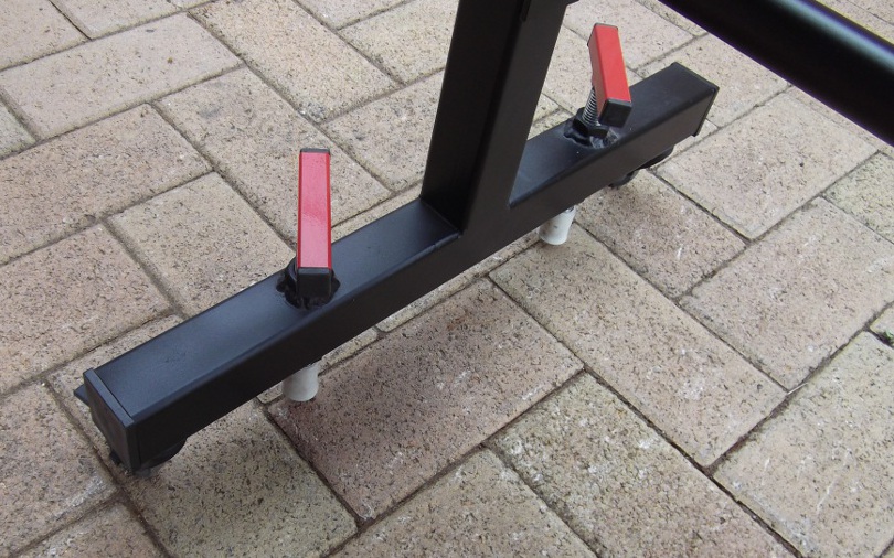

And the levelling system:

Shouldn't the axle plate locating pins be removable so you can get the frame off the jig after it's welded?
The tell tale tickle of ashphalt on the sagging underbelly of my lowered expectations.
Re: My adjustable frame jig
Neo Dutch wrote:Shouldn't the axle plate locating pins be removable so you can get the frame off the jig after it's welded?
He might have tapped the ends......but unless he has multible rear axle fixtures, all the frames will have the same width tire...I see multi holes on the frame rail fixture ! Just trying to give the newb's something to think about....
Posts: 277
Post by krymis »
on top of that depending on what type of axle setup he uses I.E.: open rear axle slot on the plate
