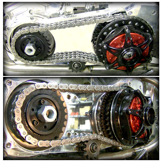

This is a pic I had on my drive for a while. I based the look on it and was making changes. I think it is an Indian Larry Legacy primary. I didn't even notice that this primary is set up with a starter, so what I'm doing here is nothing new...just different.

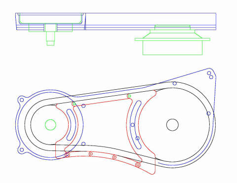

I can't tell how much the gaurd covers. If it is the part with the red outline, it looks like there will be an opening between the pulleys and between the top and bottom of the chain.
If I'm right, have you considered that an opening might let debris enter and jam the chain/pulley?

Bob, in the pic the chain is black, the guard is red. The outline in blue is the motor plat and you can see it's not completed on the bottom. The profile of the plate was what I needed to mount the motor/trans/guard. The chain is an O-ring 630, 3/4"pitch, 5/8"plate hieght, and 0.900" at it's widest. The guard itself will be thin plate over the sprockets and only contact the chain against the rollars, but be as wide and tall as the chain for ballance. I was thinking of springing the top and bottom to act as a compensator, but I just don't think it would work.

The major issue with the design is that I plan on having the lower chain guide sprung with a hidden leaf. Some have said that it would be better to have it fixed rather than spring loaded.

Personally, I like the idea of the lower chain tensioner. HD stock motors have one, and I replaced the original with a M6 tensioner with a better shoe and adjustment plates to go beneath the tensioner.
I'm still running the original primary chain with approx 80-90 thousand miles, and lotsa HP and Torque.
That is an oil bath system tho.
A metal leaf will cause considerable wear, I suppose you plan to use a cover of teflon or some HDPE material?

Sorry it took so long to reply, Bob. I do plan on using teflon or other material as a chain guide. It will only contack the rollers in an attempt to reduce vibration. What is HDPE?

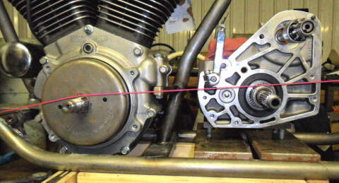

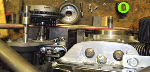

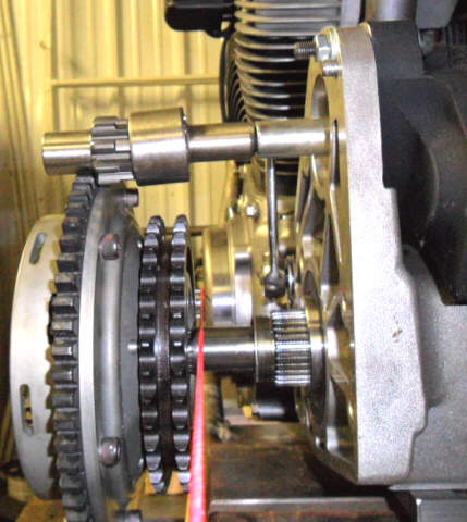

In the following pics, nothing is lined up except for hieght. I used a stock primary to line-up the tranny with the engine. Some of you may have caught that the bends I put in the seat post were too low. I had to remove the cover to line-up the tranny. I can drop the tranny 1/2" or push it back. I only need 1/4", but if I'm not stock, I might as well. The only problem with this is that if I run into problems I had planned on throwing an open belt on it. Now I gotta make it too.
I know the tranny shaft gets a bearing in all that space, but dam, I wish I could just shorten that shaft. My original thought was to swap the sprocket and ring gear. This brings up issues of tork on the shaft. The notor sprocket will also be way too far outboard.
If I could shift the tranny inboard, it would resolve "some" issues with motor sprocket. Approx 1" would bring the right side even with the cone.
The string line in the pics is resting on top of the motor shaft and axle. This was to provide some referance to how the chains will line up. I'm definately needing to sleep on this one. The easiest thing is to just leave the sprocket and ring where they are. But, where's the fun in that.

The 1st post showed that they moved the ring WAY inboard, and the sprocket slightly outboard. You can also see that the engine sprocket is far offset. This is the issue that gives me the most concern. I want everything in tight and close.
You can see from the pic that they made a bell housing to mount everything with the offsets. That is easy. There are many offsets to add-up, and I don't like the way the numbers look.
