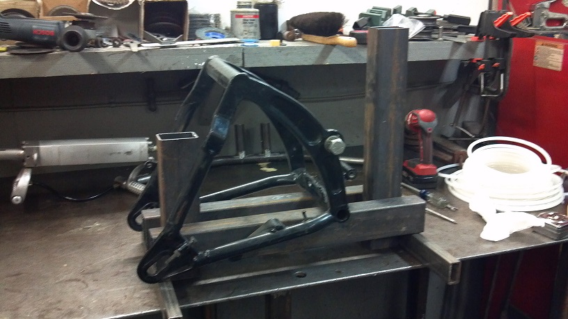

when i set up my frame jig i based it useing a factory softail frame and i made enough room so i could build the swingarm on it too but after building my first softail frame on it i found it limited me a little . i been thinking about it for a lil while now and decided to build a jig just for the swingarm . i still want to base it off a factory swingarm so i can be sure ill b able to fit them to factory frames if need be but hopefully it will be flexible enough to play with the design a bit . if nothing else it should be easier to spin arround and tack things up.

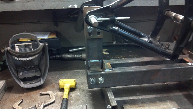

i picked up a swingarm on evilbay fairly cheap turns out was in good shape got some 2x3 and 1x2 rough cut to the size i think will work . i made the base 2 foot long and the legs 14 inches and the axl tube the same as my frame jig at 12 inches ended up late so no time to drill holes . i want to make everything bolt together so i can change fixtures easier as i go or change designs and still be able to go back if things dont work out

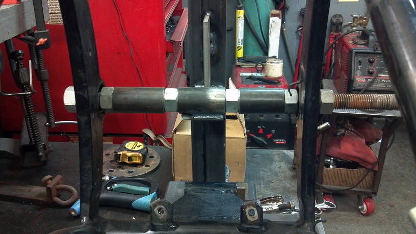

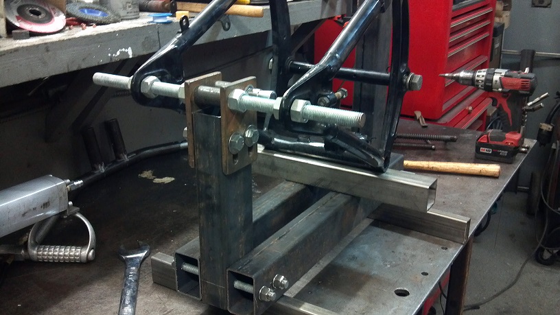

got the axl tube all mounted with adjustable plates and spacers so i can go up and down and wider ran outa bolts for front tube had to use allthread no nuts either so had to stop there have to hit fastenal monday . going to pick up some thread couplings too for the 1x2 so i can level everything up . thats ok though still need a lil more thought on how i want to make the front tube attachments

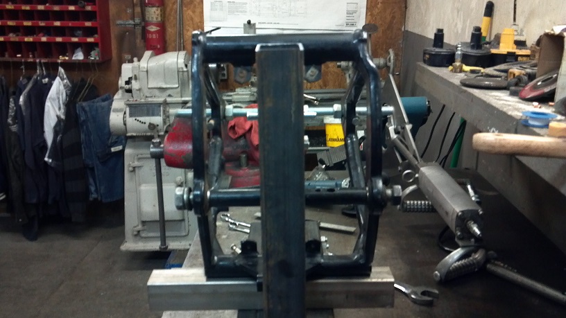

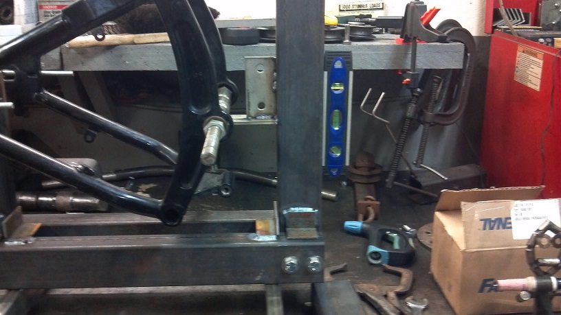

finally got the hardware from fastenal was able to level everything out plumb the uprights and spun up some spacers to make sure i get the pivot points in the right spot and welded some bits of angle iron to make sure the uprights go back in the same spot . now i gotta figure something for the brake mount and a way to indicate where the bends in the tube are so i know i wont have any issues with tire or belt rub .
