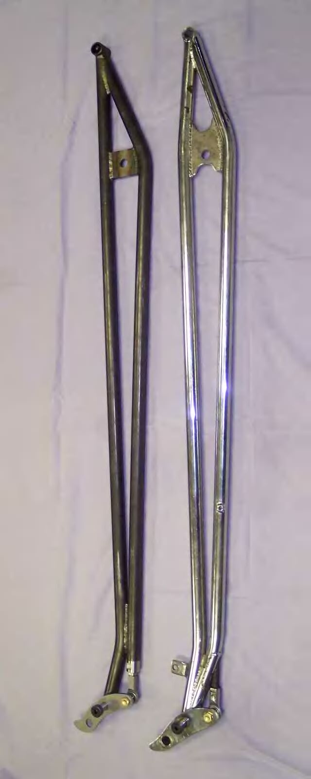

If you hold a piece of paper in the centerline of the neck, it looks to have slightly neg trail.... I ran into than on my leafer, when I designed the rockers to run the wheel in front... but mine was 4 to 5 inches... it might be a problem . But you can make rockers to move the wheel back some ... I don't know enough about these forks to say .... but you can ask Jaxon Davies... (Jusjaxon) on here and CW... look at his frontend and see if it is different. His forks use a replacable cartridge and the spring can be changed or adjusted. I like his frontends better !

the patent ran out awhile ago so there's no legal right to the design. you don't see anybody getting on jaxon for his design. but he did change it up by using a cartridge. i personaly like what jaxon did. not as clean as johns design but better in the fact that you can do something with the spring setup.
