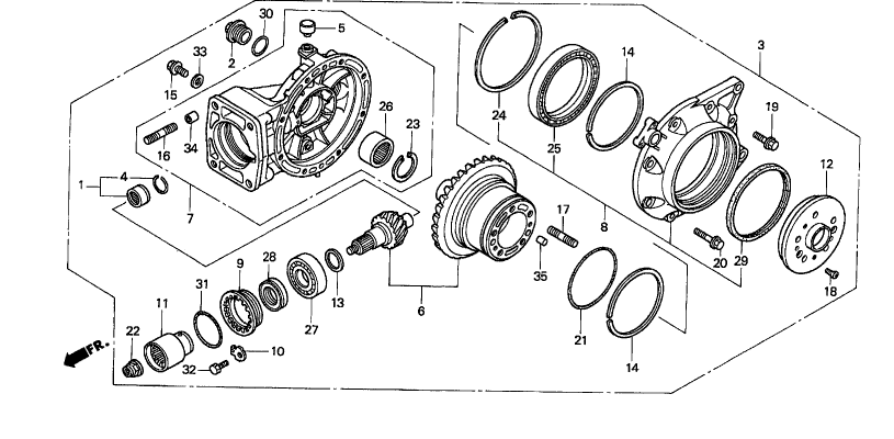

This is for a GoldWing. Got it on BikeBandit. The biggest problems I see are the large bearing/seal and the weight of the hub.
Re: home brew right angle drive
that GW final drive isn't a 1 to 1 and if yer trying to put an automobile engine on two wheels a 1 to 1 is what you need !

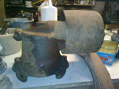

I got one of these :D
What did that come off of Max ??

That comes off the back of a tractor transmission for belt drive inplememnts, which are pretty much extinct these days. I love old barns me.. :D
