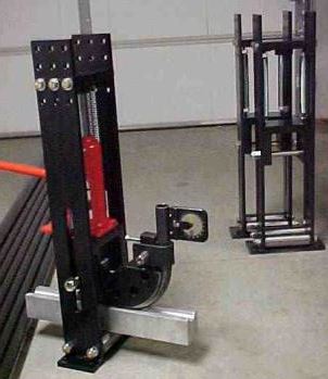

I'm trying to decide which of the two tube benders posted on the main page that I should build. The original JD2 model or the CBH model. Is there an appreciable capability difference between the two? I noticed that the JD2 unit drawing specifies that it is set up for 4.5" CLR dies, but can it use other radius dies?

ok that hydraulic "monster" looks like the ticket. Are there plans available for that machine?

Re: Which Bender to build
Thats the style I built, a bit different but same style, i dont have a decent pic so i wasent going to comment, I like it as the tube stays level and I use a magnetic angle finder. The only thing is it only does a 90 or a bit more, mine has a big base and is portable yet very stable..I am kind of thinking of building another one of a different style just for fun and makeing my own die on the lathe..the first one I bought the dies from pro tools
I have a horizontal bender at present.
It works O.K.
I think this one looks interesting. Seems very compact, & I probably would not be bending past 90*
