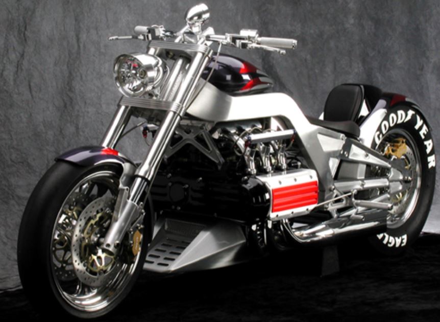

I am impressed you found one. Not as simple or elegant as I would hope to do it, but it does lend a bit of credibility to the idea. Thanks for the reply.

You could easily "recreate/reverse engineer " this in a early Buell or Ducati style frame, using small diameter tubing .
I originally saw this image online 15 years ago. I have liked it ever since.
