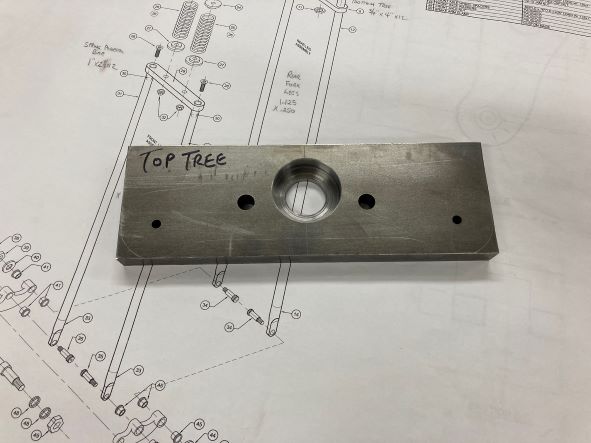

The top tree plan view (sheet SF1.1) shows the outline of the large dust shield and the 1.250" bore thru for the steering stem (section D-D), but doesn't show dimensions for the counterbore that allows the bearing adjuster nut, lock washer and bearing lock nut. This scales out to about 1 15/16" dia. x 1/2" deep (on sheet SF1.8 - Typical Steering Neck Assembly).
Can anyone verify this dimension for the counterbore before I start cutting? :pray:

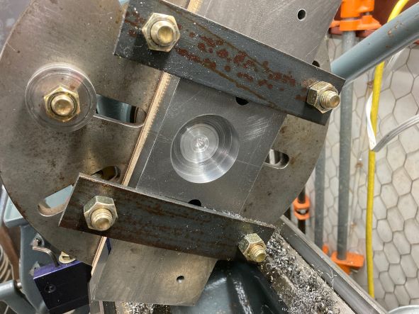

Too late - counterbored to 2" dia. x 1/2" deep (measured from bottom of tree).

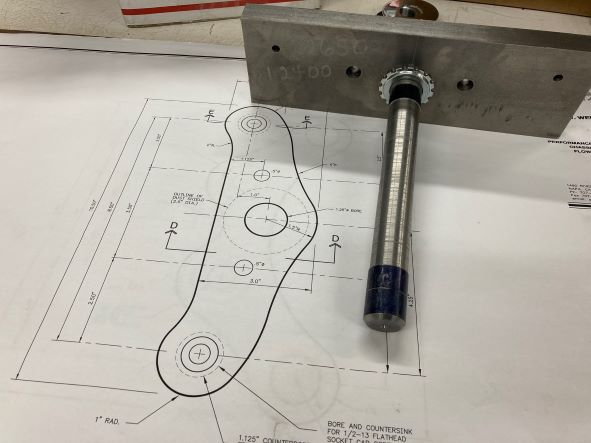

I can't figure out how I got it wrong, but the stem lock nut and jam nut needed to go up into the top tree so I'd have enough threads for the cap nut to attach to the stem. I'll reassemble the trees and take a pic so you can see what it looks like.
